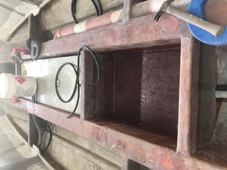

Default Fuel Tank and Rigging Tube
Went with 87 gallon fuel tank. Plan is to run a Evinrude G2 250HO. Should have plenty of range with out all the extra weight of fuel.

Default Fuel Tank and fish Box
Fishbox is 24 wide by 48 long and about 15 deep. Hope to fill it up soon!

Default Rear Dry Storage behind Fuel Tank
This is 36 long by 24 wide and about 16 deep. Possibly will put in fresh water tank in part of compartment and then who knows what else I will keep down there.

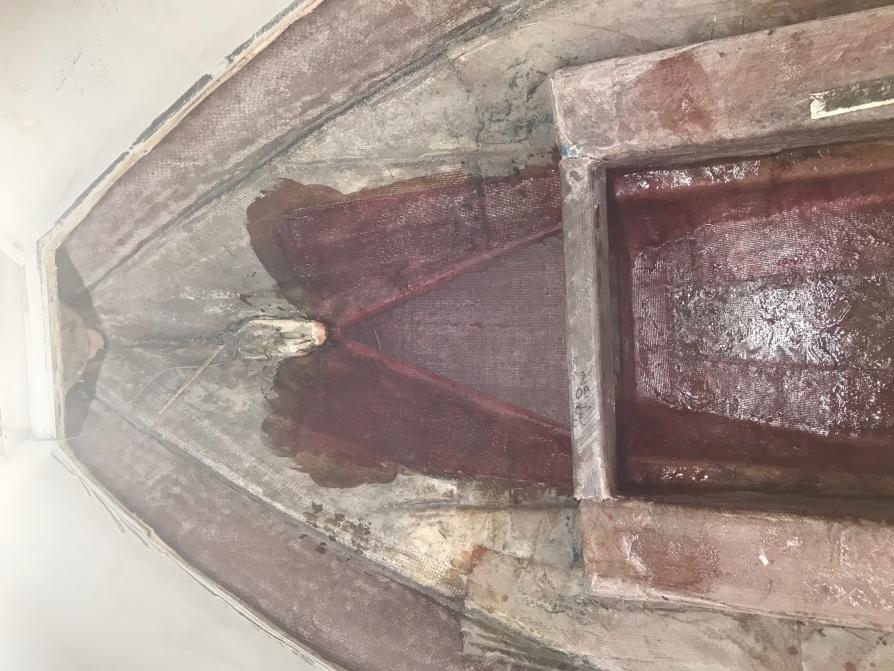

Default Front V Area Storage Futured In
We still have not opened this up yet but it will be a perfect storage area. Still deciding how to do dry hatch. More to come.
