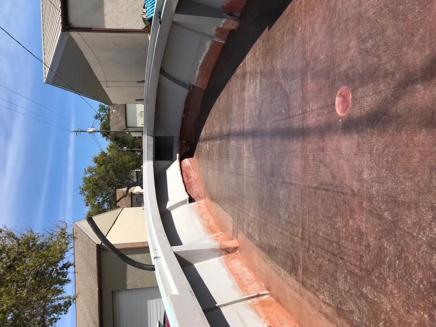

Old 04-17-2018, 10:05 AM
Join Date: Feb 2003
Location: tampa
Posts: 51
Default Floors Finally Installed Lots of Coosa
Awesome to have 3/4" Coosa Board on the floor now. Coosa was bedded to stringers with Arjay bedding compound.

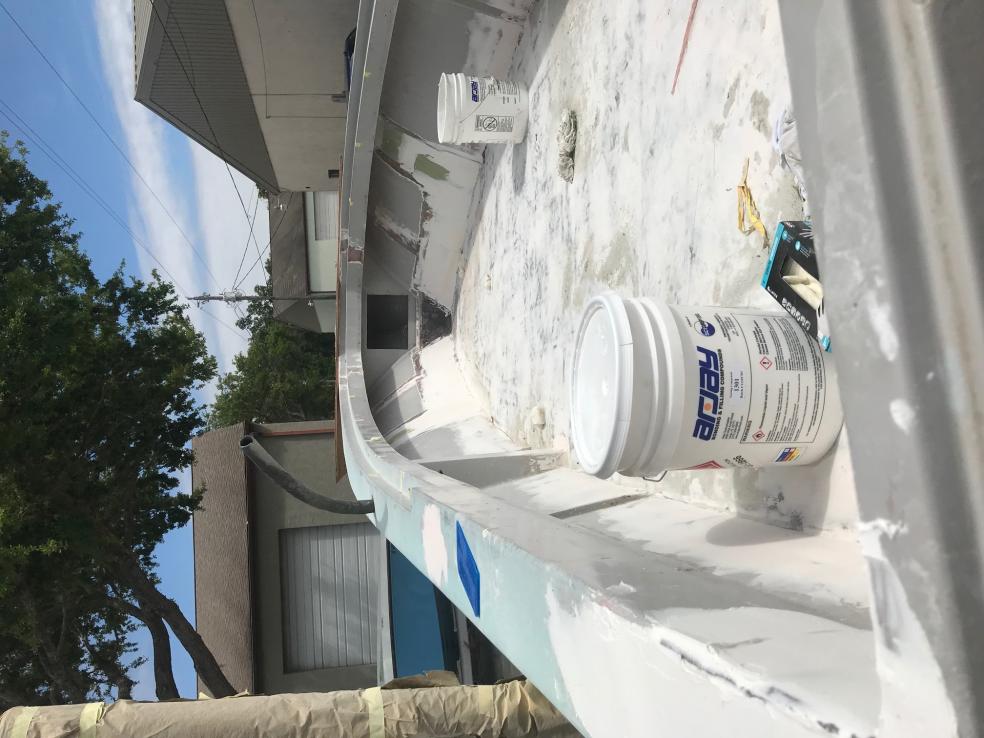

Old 04-17-2018, 10:08 AM
Join Date: Feb 2003
Location: tampa
Posts: 51
Default Fairing Going on Floor and Sides
Arjay fairing compound going down. Sorry for the sideways pictures. I have straightened them our on my end but every time I attach they rotate left or right. Tilt head if needed!

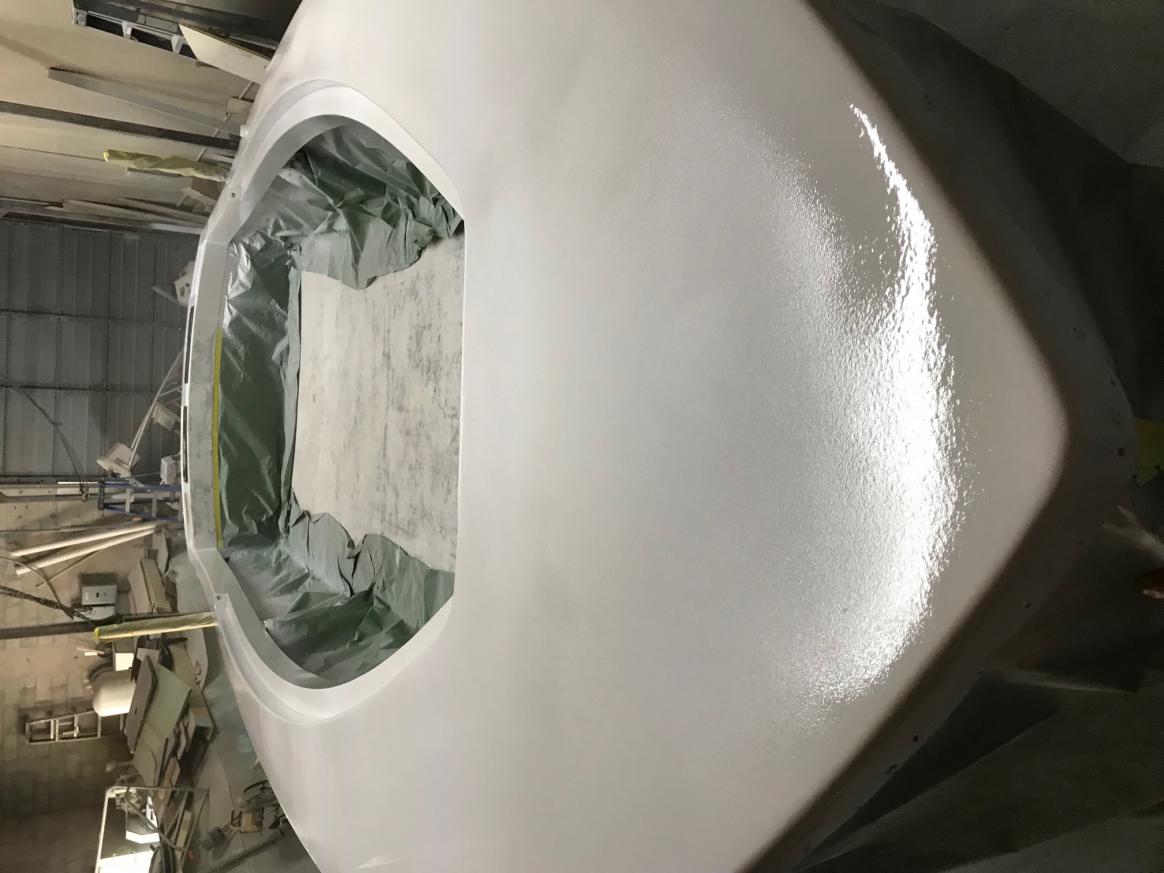

Old 04-17-2018, 10:10 AM
Join Date: Feb 2003
Location: tampa
Posts: 51
Default Top Cap has been Recored with 3/4 Divynacel
Gelcoat going on top cap

Old 04-17-2018, 10:12 AM
Join Date: Feb 2003
Location: tampa
Posts: 51
Default Gelcoat on Top Cap
Staring to really look good
  #29
Old 04-17-2018, 10:13 AM
Join Date: Feb 2003
Location: tampa
Posts: 51
Default Another Look at the Top Cap
At least 4 passes of gel coat should last a while

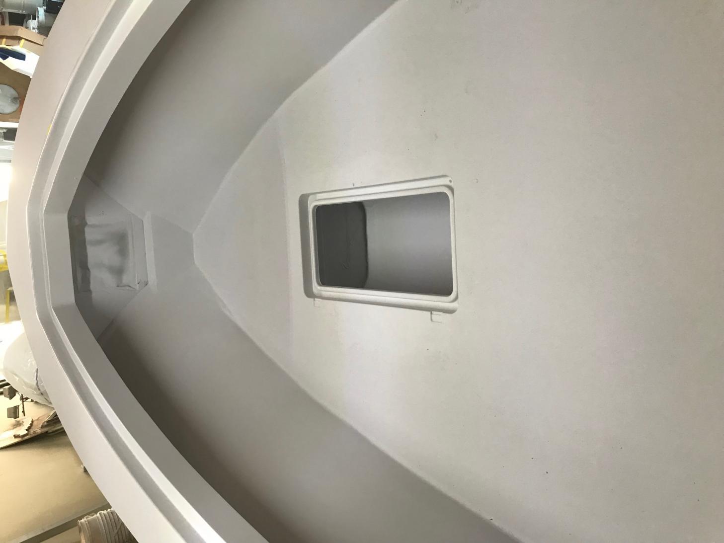

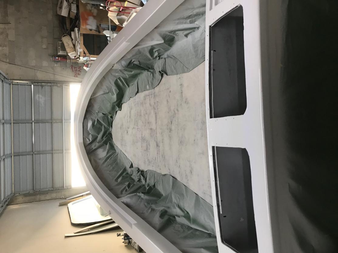

Old 04-17-2018, 10:15 AM
Join Date: Feb 2003
Location: tampa
Posts: 51
Default Hatches Cut and Floors Gel Coated
Love the Hatches JV installed. They are out of a Mold from Andros.
