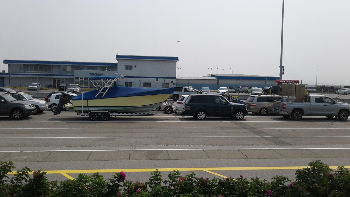

Mine is a 23, but principles are the same. I originally had my rear bunks set so they were just inboard of the 2nd chine resting on the middle panel. While apparently this is the best structurally, I found it did not center as well. Also, the further out you go, less of the bunk actually contacts the hull unless the bunk has alot of flex. See pic 1

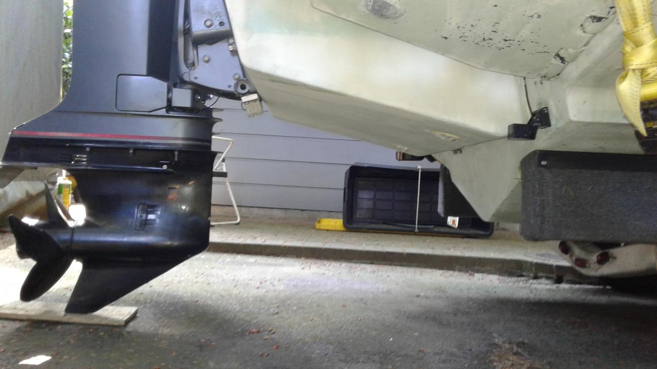

My current setup has the back bunks just outside the most inboard chine, again resting on the 2nd hull panel. I think the structural support is almost as good and the boat always centers itself perfectly. I do have forward bunks that guide the bow into the center of the trailer. See pic 2

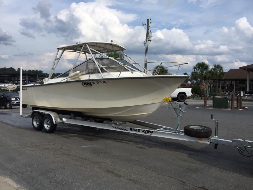

The only thing I would do different is change the cross member supporting the front of the forward bunk. Right now it is straight across. I would go for one that has a dip in the center so my bow could rest lower. See pic 3
