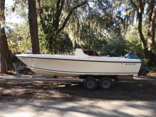

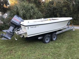

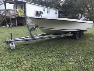

Was trying to show where gutters began. Think I’m going to end up going quite a few inches forward. Once this thing is glassed to the floor there really ain’t any turning back! Haha. Have a pic of her sitting outside on the trailer that will be sold with the 1976 Seafari, The Blank Canvas, original FastLoad to the 1979 MA. Cannot figure out how to post multiple pics from my library. Guess I fingered it out...
And yes, bunks fully extend to support transom.
