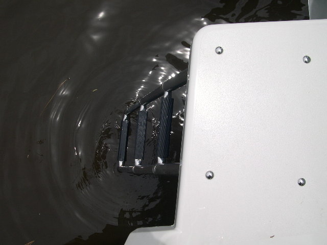

I am not to sure if this helps but I used hurricane panel bolts with low profile nylon lock nuts so the Mrs. doesn’t snag her suit.

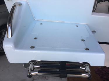

Old 12-07-2018, 10:10 AM
4 Flush toggle bolts worked for me. No issues

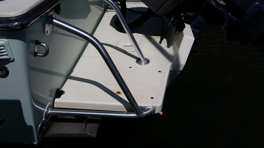

Old 12-07-2018, 10:18 AM
New owner installed hand rails

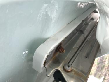

Looks like Capt. Chuck had a ladder possibly with more “drop” in the mounting brackets than at least the one I have.
Mine is shrinkwrapped for the winter but managed to get a couple pics to confirm 3/4” thick starboard allowed the ladder to clear the aft lip of the platform. The one downside is I keep the boat in the water for the season and the ladder is so close to the water that it’shard to rinse without immediately dipping in the water when you step off the boat or it just gets splashed when the wind kicks up so the salt takes a toll...
