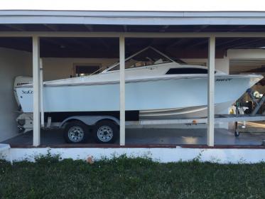

Old 02-19-2019, 09:52 PM
That’s a tough one, as I am in SC. Would my ‘79 MA be similar? As my Seafari is currently stored, I believe trailer at level, and my Etec vertical. Check it out. My neighbor has ability to true engine with battery power to T/T if not “square enough to set a beer on it”, ideal trim. Haha
