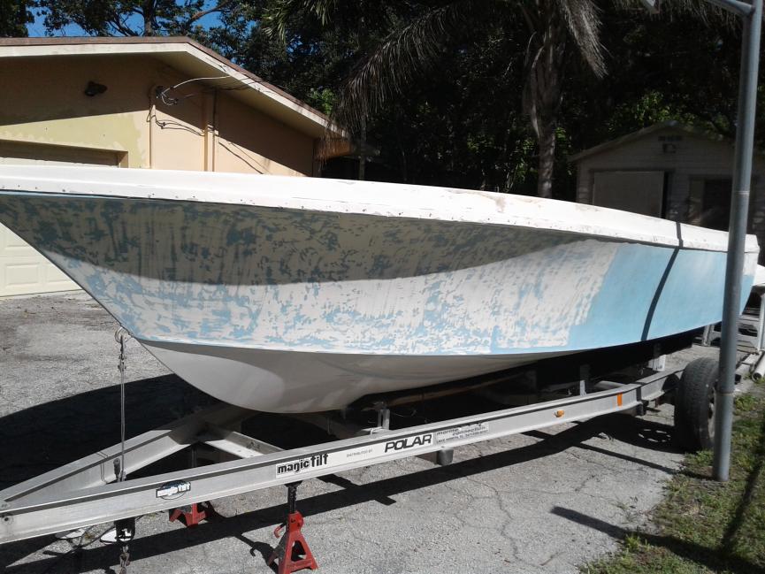

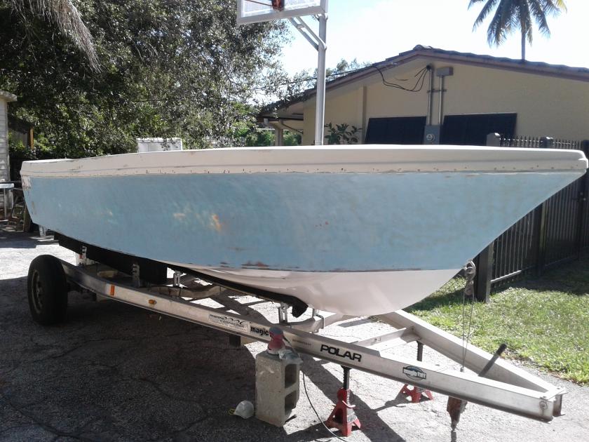

I sanded down the white primer on the hull sides down to 180 grit in anticipation of sending it off to paint. Just need a little more but it's so HOT that it's hard to be outside.
Next I'm going to fair out the deck and apply a coat of gel coat along with the transom splashwell area.
I have the interior sanded down to 180 grit except for the floor and transom area.
I maybe getting close to getting her painted .
It maybe a 2018 model boat ...2 years of what my wife says
