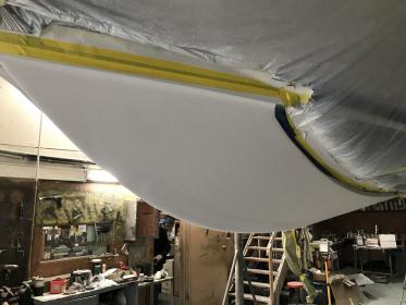

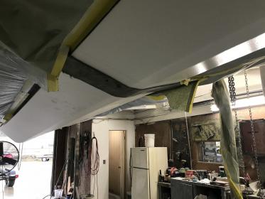

Been a few week but finally got so forward motion on the boat. The fiberglass guy has been super nice and helpful.
First the motor looks good about 120 psi on the compression test. The wiring was a mess and the motor is mix of 3 different years so prob had a head swap.
Then dropped the boat in the water to check for leaks and ran the motor but due to fear over how the steering was set up, ( one link arm and the brackets where screwed in to transom not bolted) he did not go far lol. So I went head and got a Baystar hydraulic steering kit.
Had a scupper leak, (fixed with new hose) but no other leaks found.
Even though the transom was sold it had a ton of holes and cracks so we went a head cleaned and glassed it up BUT once she was lifted he spotted about 5in flat spot in the keel that is not leaking yet but damn close.
Looks like its from poor trailer set up in the past so im going to read up on extending the bunks as currently to much weight is sitting on the rollers. If anyone has suggestions im all ears.

So what are you doing here? Just coat of glass on her keister, fill the holes and fix the trailer burn?
Yeah he glassed the keel then gelcoat. He did say sanding it was a nightmare lol.
The trailer is looking like Im going to grind off the rollers and just do forward bunks, at least thats the gist I got from the threads I read.
