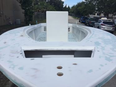

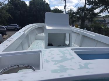

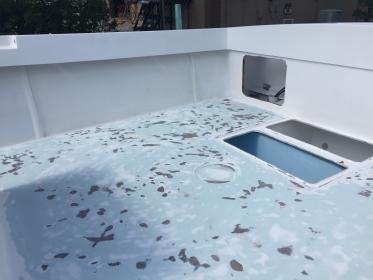

It’s at the painter now. Here are the pictures after I guound it down.
