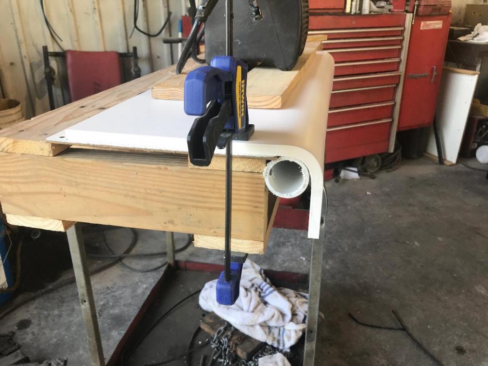

A little overdue, but, here are some pics of my leaning post. It was powder coated in white so I media blasted where the welds were going so we could get it to the size I needed and reinforced adequately. After getting it right, I decided to paint it so I media blasted it, primed with self etching primer then several coats of Rustoleum. Took awhile to save my pennies, but finally got the cushions made. I took some 1/2" azek board to make the backing for the lp cushion. Found the radius I wanted and heated the material until I could get the bend I wanted. Worked very well! Anyway, here are some pics.

Sorry. I guess a downward angle changes the orientation of the pic. Ugh!
