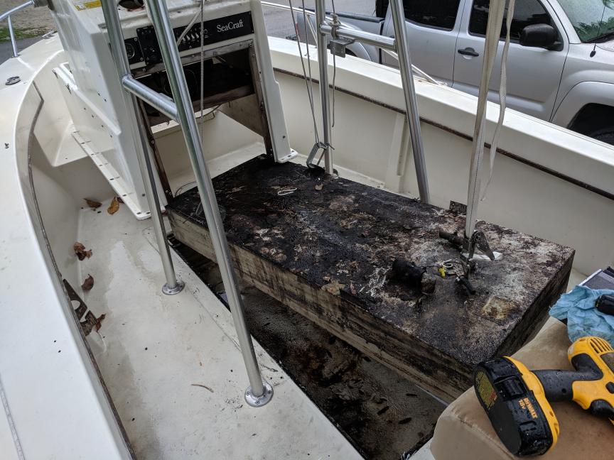

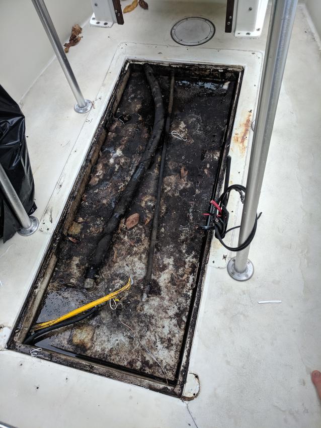

tank well was full of water, to my surprise the tank was a newer 50 gal tank (8"x24"x60") not leaking but it did have heavy corrosion below,
Look at the four holes I drilled at the back of the tank well, on boats, water always gets it, it must have a way out,

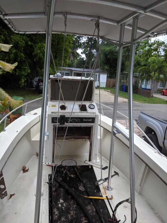

The console on this 18 does not look like the others, it's definitely taller, there is no evidence of modifications tho, either way, this is one of the main things why I chose this particular boat,

Sometime in the very early 80's the consoles changed to the taller ones on the 18 and 20sf

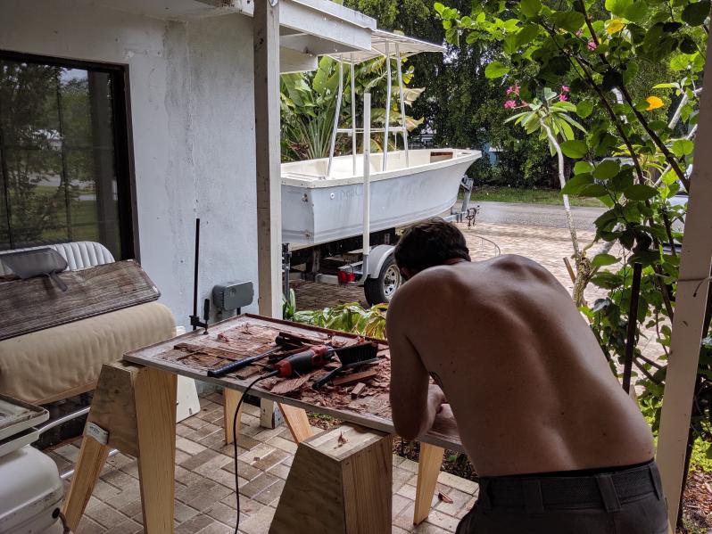

Demo Continues,
Itchy as hell today, it was so hot and humid I went sans tshirt all day, removing core all day, i'm down to the side coamings now, the core was basically liquid,
I have the week off work so Im hoping to get the all the cores off this week and get the outboard removed,

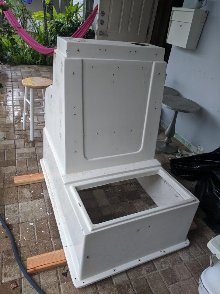

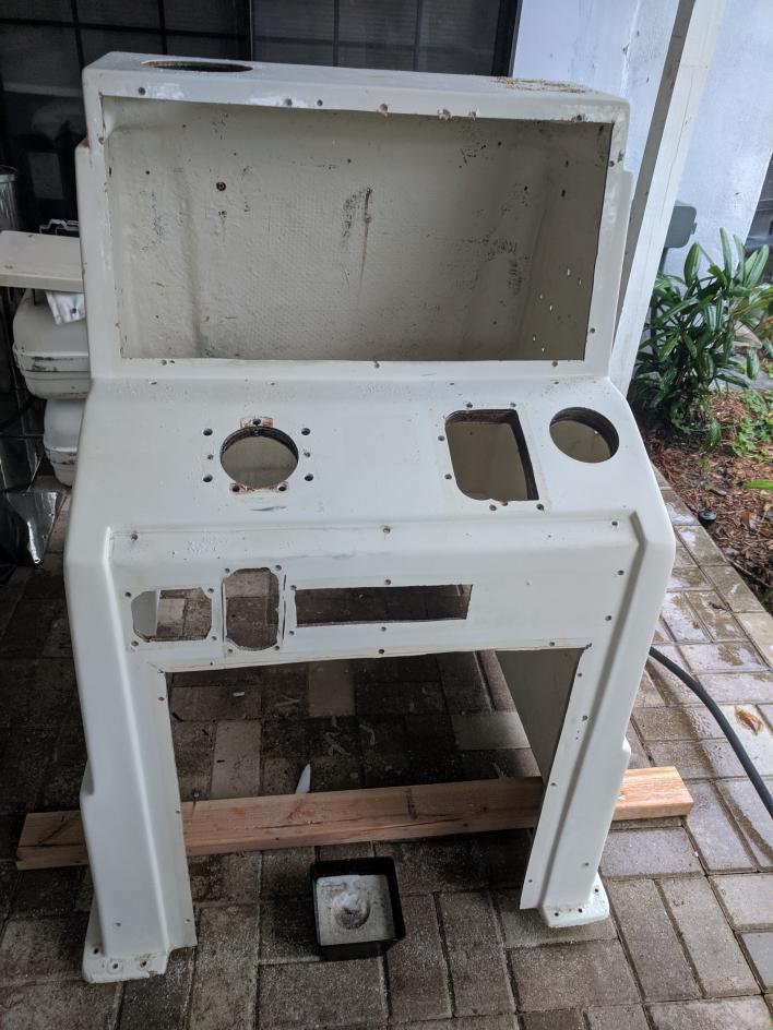

I am currently sanding and prepping the console, it was gel coated on the inside and there was a bunch of different types of paint in there which had to be sanded off, will sand the entire inside back to bare glass, reinforce and add a coosa core to the sides as the new t-top is being bolted directly to the console, also adding coosa further up to screw electronic components into, and then seal the whole inside with an epoxy primer,
