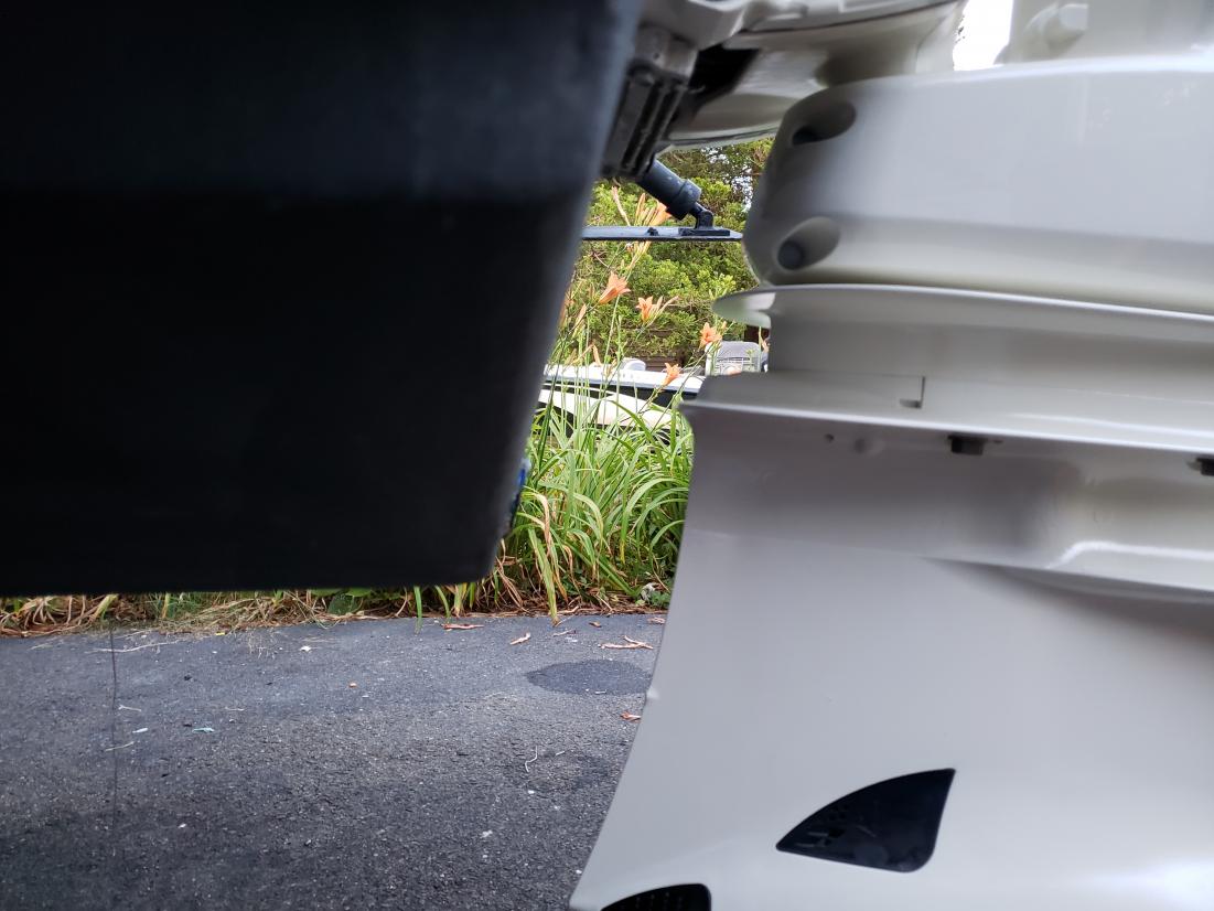

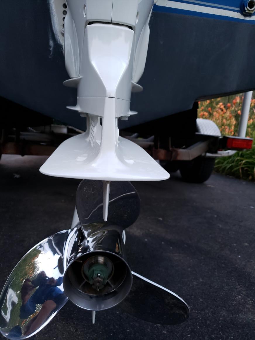

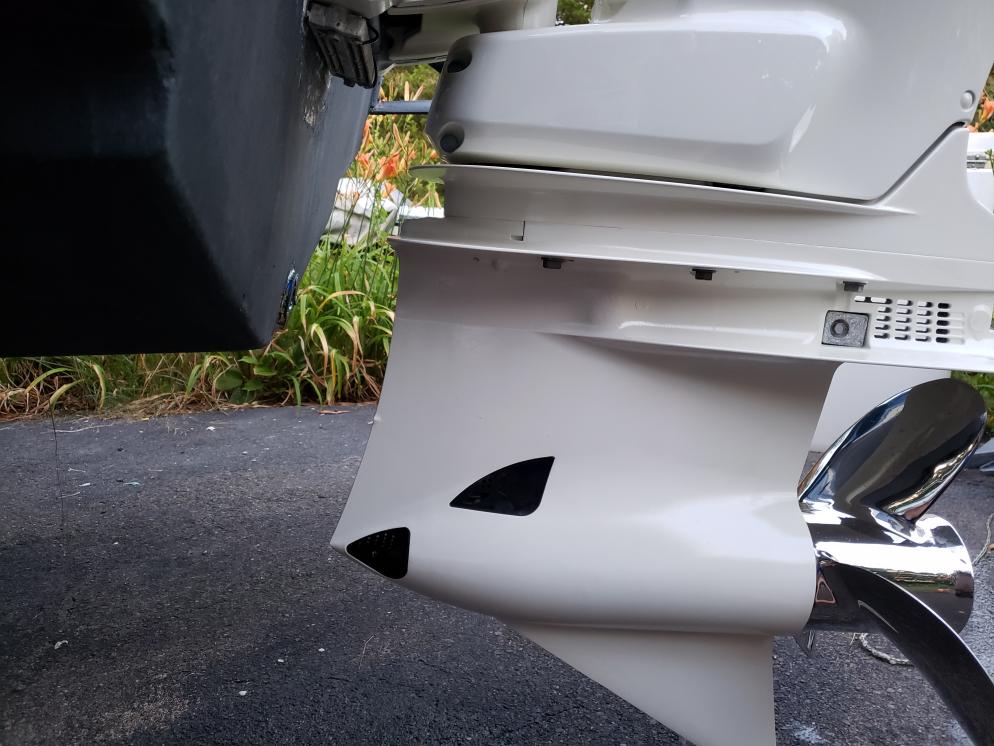

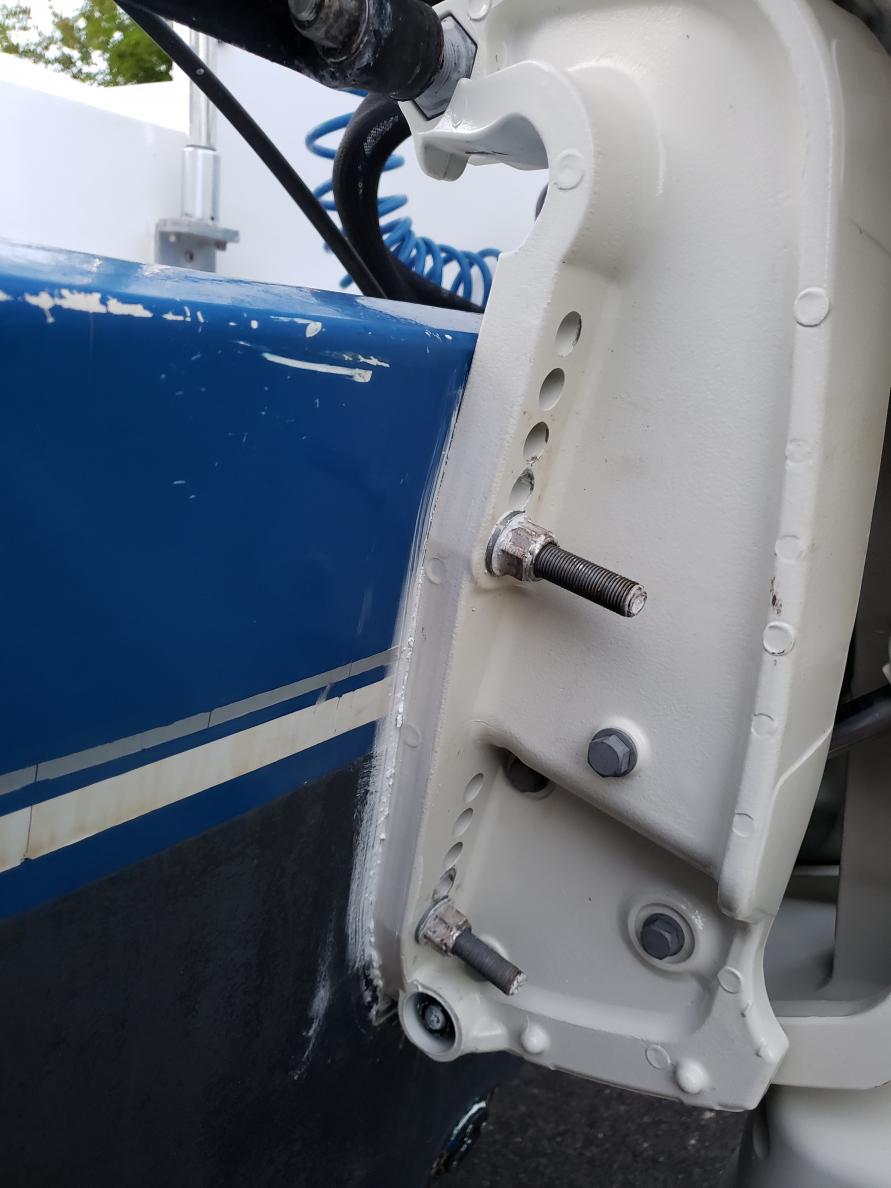

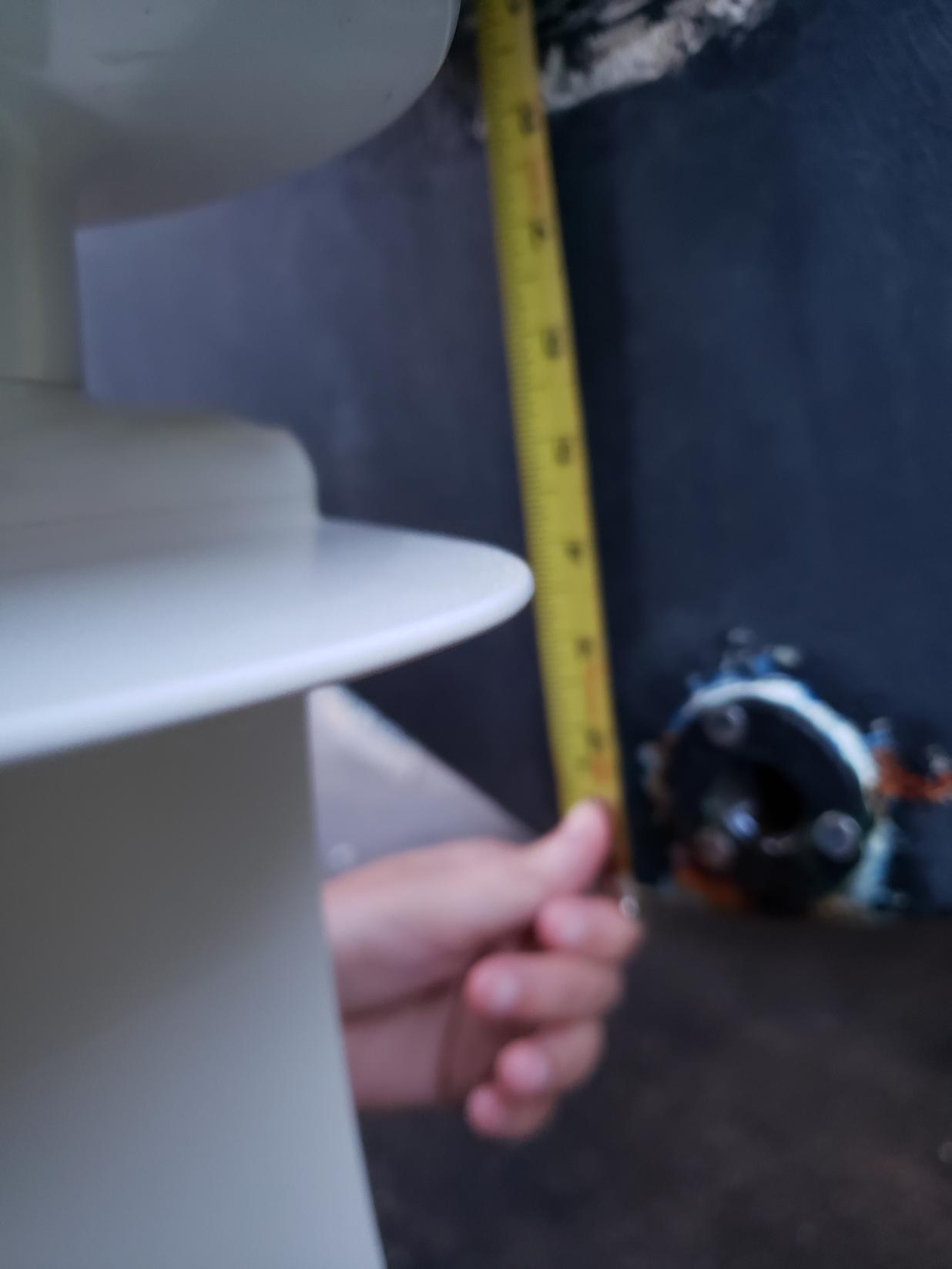

Ken, you are pretty close. Your fuel burn is in the ballpark as you are using knots and nmpg where others use statute. Take some pictures of your set up looking from the back at prop level and from the side and post them up.

The speed is in MPH. If you need more photos let me know.
