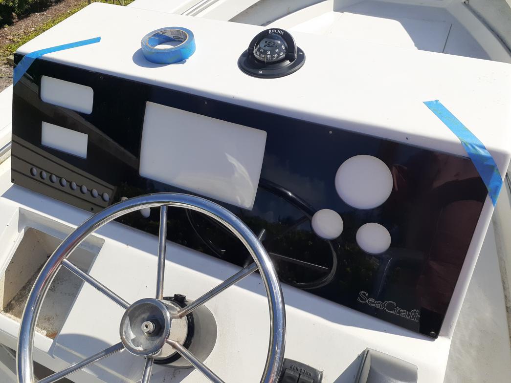

So in between work and the rain not much progress has happened. I did get some things ready to be installed when the afternoon rains let up. Bought some PVC board and mounted the 2 bilge pumps to it ready to be glued down in the bilge. Also have the Livewell pump and valve ready. I have been buying small things like new hinges and popup cleats, hoses, blueseas fuse box, bilge access hatch, and many other small things......boy do they add up.
Purchased a Icom VHS radio, Garmin 94sv, and fusion stereo and speakers and ordered a black panel for the console to install the
boca tech switches and electronics, so when the time comes it's ready.
The budget dictates that I use my existing leaning post so I had it powered coated white as the aluminum was in poor shape and I'm have made a new cushion. It's going to have to do for now.

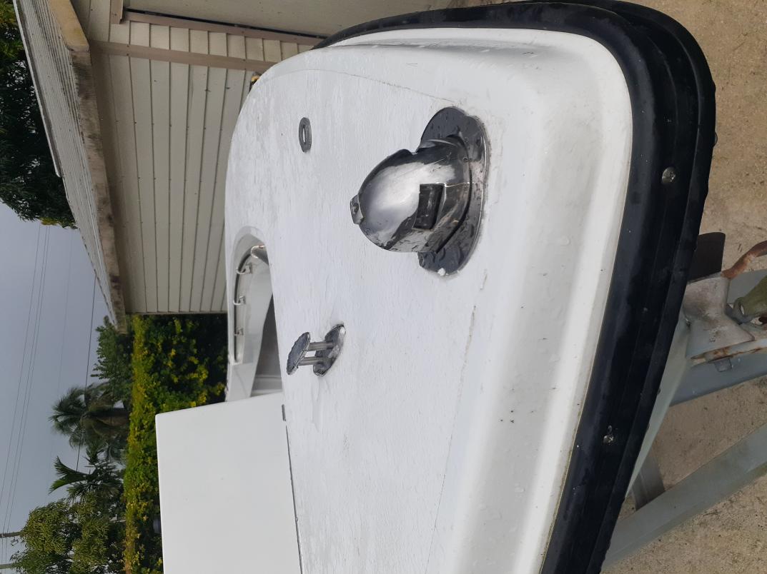

Old 09-26-2020, 04:07 PM
With the rain today all I was able to get done was the bow light and pop up cleat

Old 10-08-2020, 03:10 PM
Picked this up today and it will be installed later ...its too hot right now
