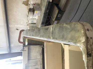

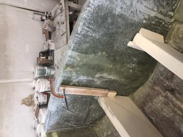

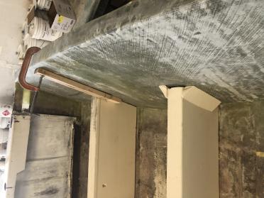

Hey Y’all, between Covid shut down and a torn rotator cuff I have been dead in the water. I just now am able to get back at it. One 1.5 coosa transom in, and stringers out. Adding one more sheet of coosa for transom and then will be boxing in a stringer system to today’s standards. 4.5 inch higher deck with thinner stringers for maximizing in deck storage. Hopefully this new momentum continues

I got the two1.5 coosa sheets laminated with lots of glass. ( epoxy entire project). The total is 3.7 in thick. I’ve mocked up the stringer with nida core and will start glassing them in soon. Then I will box in my bulk heads and rest of lateral supports for hatches.
How far do y’all place the center of the console on a bracket boat from the outside transom skin? What is the factory distance ?
Thanks for advise and help
