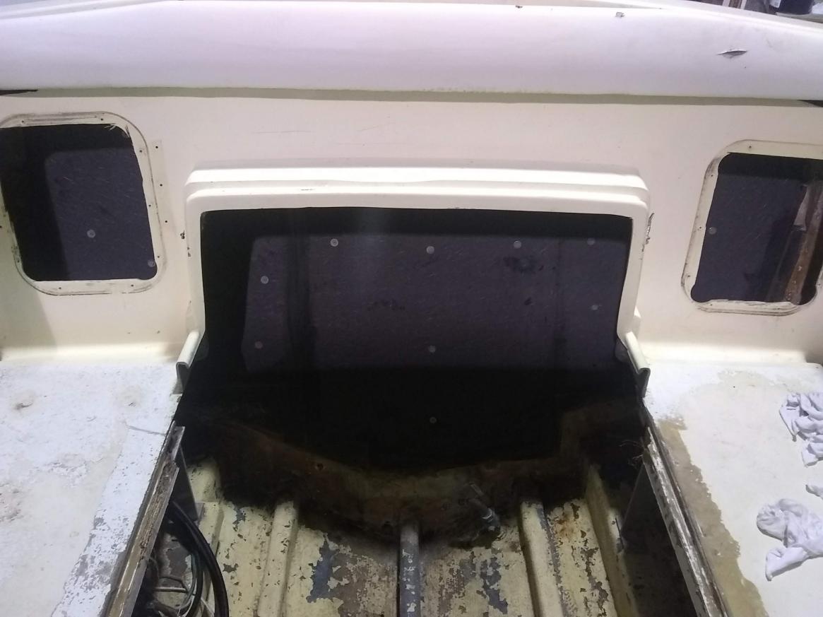

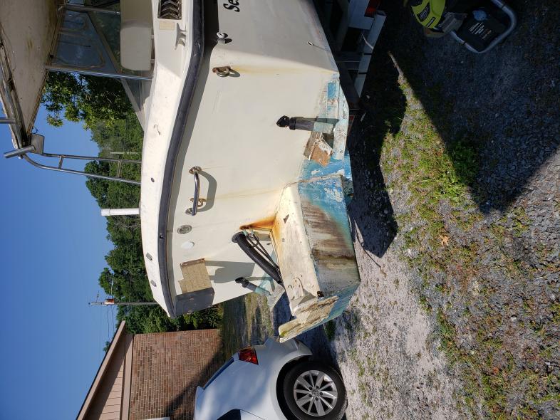

Paid $3k under the one condition that the seller keep the ficht Evinrude mounted on the back. Upon looking the boat over there was one soft spot on the deck, the bulkheads forward and aft of the fuel tank were rotten, and the transom was highly suspect. Turns out (as if the colony of ants weren't a dead giveaway) it was completely gone.
Since taking ownership we have remedied the deck and bulkheads, as well as a full coosa transom. Moving forward towards picking a new motor I am hoping for some input. The old 520 pound Evinrude 250 was mounted on a Gil bracket that came on the boat and I believe the boat was fished hard that way for ~10 years. Is there any reason not to mount a 300 Suzuki on the same bracket and (forgive my slang) send it?
