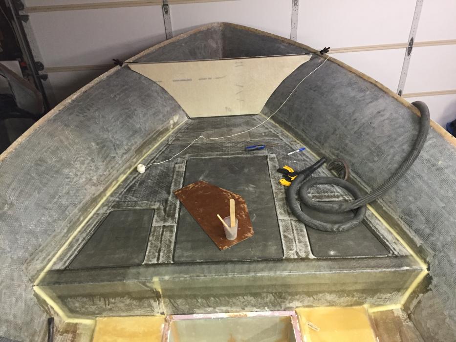

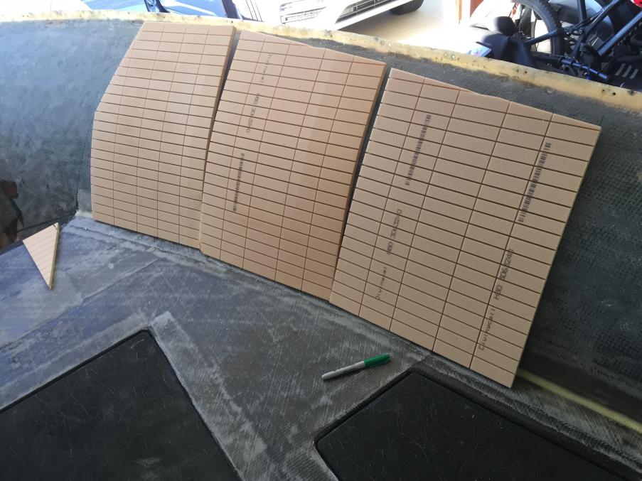

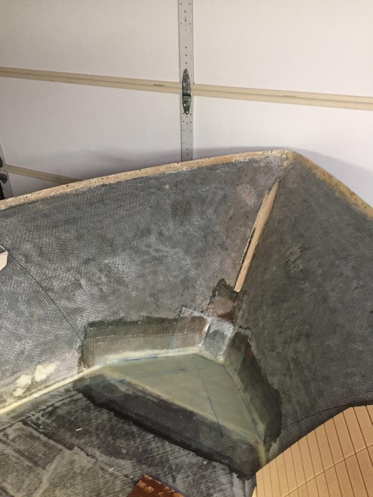

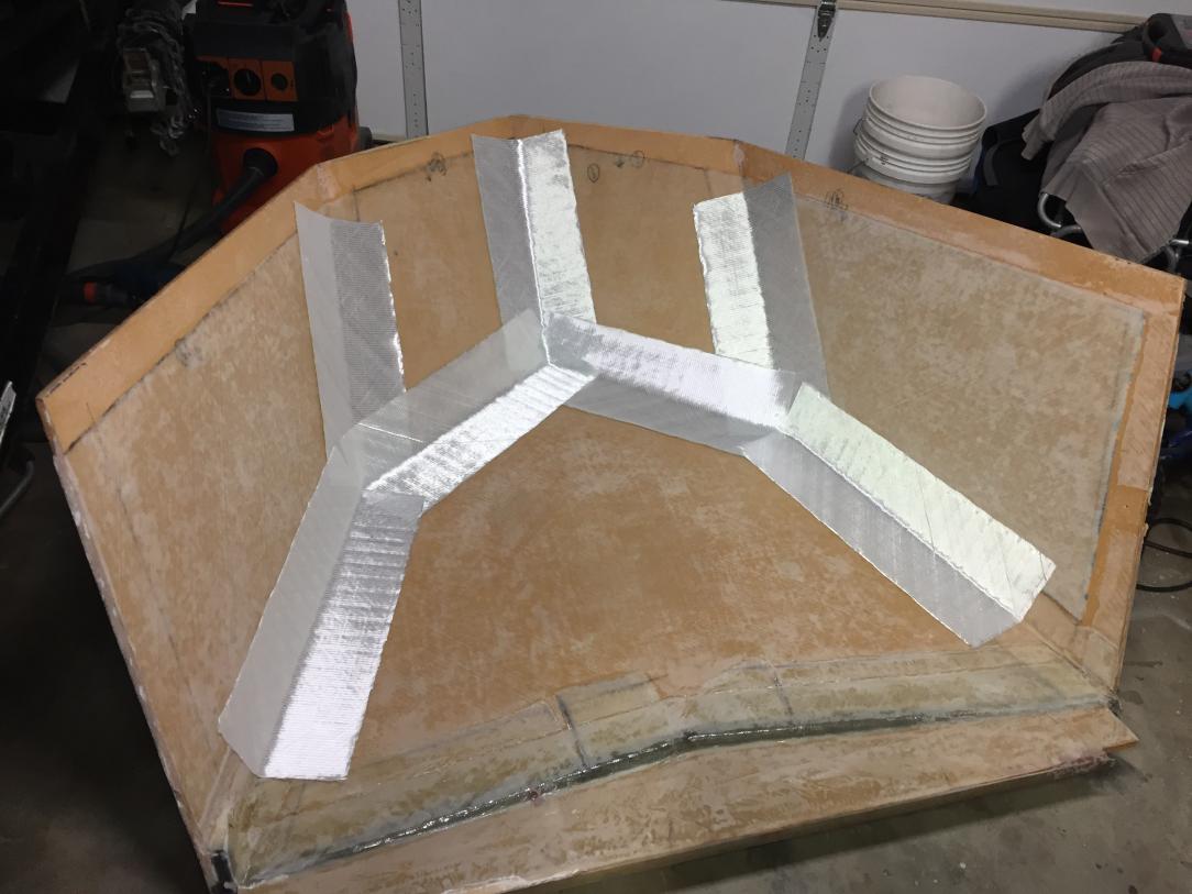

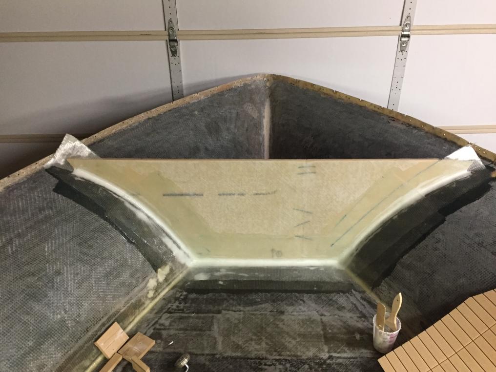

Things are progressing. I've been trying to get one or two things done each evening after the kids go to bed. I'll be coring the hull sides next. I had trouble finding the scored Divinycell so I did a table saw scored test piece which worked so I'm going to continue. The biggest disadvantage I see is it'll take more filler to smooth out the Kerfs.

Something like this might make thinner cuts
https://www.amazon.com/Bullet-Tools-.../dp/B00KM0RLUU

Will the bulkhead on the casting platform be glassed to the cap or just tabbed to the hull sides?
Nice looking work.
