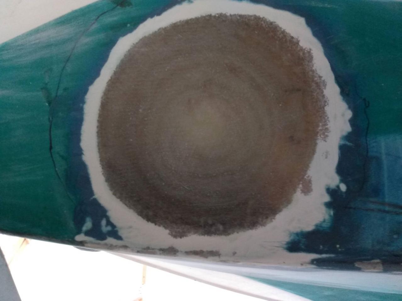

They are getting there. The glass is 17 oz biaxial. I am using epoxy and didn't want to have to saturate chopped strand mat. I'd rather do a couple extra layers and get the strength from the glass.
Two more layers on the head thru hull patch on the outside and two on the inside. Inside layer on the kitchenette sink drain hole too. The transom patches are just about done. The lower unit keyhole needs one more layer in one small area. Sanding down nicely then they will be ready for fairing. That will wait until the rest of the hull is ready in the spring.

Thru hulls are getting there. A little fairing and some paint and this one should be good to go.
