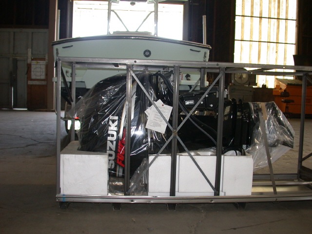

we had many pictures and even some diagrams of the Seamark brackets but it still did not answer all our questions as we could not see it from every angle as to how they were built.. I found this picture of the first one I built...all epoxy...over kill to say the least but I ended up hanging a Brand new Suzuki 250 on that boat after the Yamaha kept giving me trouble.
