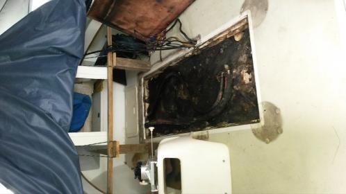

I replaced the tank in my ‘87 18cc last year.
These were all my measurements.
L60”xW24”xH8”
Hope this helps.

Well, that picture didn't come out well.
Old 01-27-2021, 03:35 PM
Thank You! Exactly what I needed!
