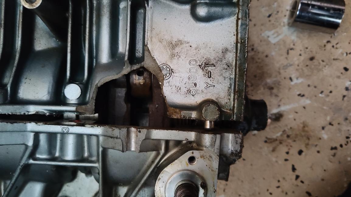

So I started tearing apart the rest of the engine. Apparently it's worse than what I thought. I didn't notice this till now.
So unless I run across a very cheap power head...is a parts motor. I already took apart most of it and bagged all the parts
