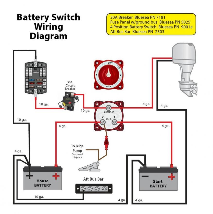

Here's what I plan on doing as far of the electrical

I highly recommend an ACR.

Looks like a solid beginning point Jorge. In addition to acr between bats. I’d suggest putting mega fuses on each battery positive lead. Breakers if you wish but megas will provide protection in the unlikely event something happens on that length of cable.
When you say ACR, I presume this is the auto charging relay. I've never used one of these so I don't know the purpose. I think it routes the battery charger through the switch. In the past I have just hooked up a 2-bank charger directly to the batteries.
Can you please let me know the advantage of the ACR?

ACR will keep two batteries charged yet separated while main engine(s) run. The battery switch that comes with the system allows combining also. It's a must have for me.

Got it! I wasn't thinking about the motor charging, just the Guest 2 bank charger. I have always stored my boat with the charger plugged in. Two green lights means I have two charged batteries. I use one battery all day and the other is charged and ready if I need it.
If the ACR is truly reliable, your way sounds better since it's keeping both topped off. Sounds useful if I'm in a place that I can't plug in overnight. I'll be looking into one.

Here’s a link to what we are talking about on the acr. The switch also has 4 studs instead of 3. But both exist and will work fine if don properly.
https://www.bluesea.com/systems/42/2...ctrical_System
The acr separates them discharging and combines when charging.
