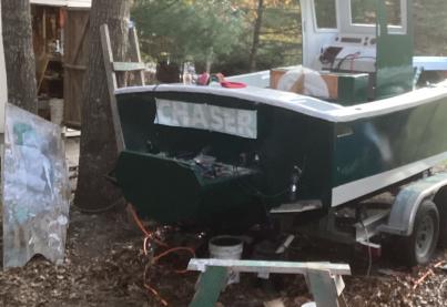

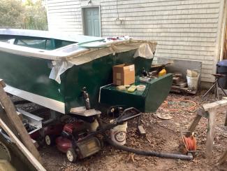

Whelp, the bracket got installed and hasn't fallen off yet, so I can post those photos. Shrimpin' sent me the original drawing, but all subsequent mistakes, errors, and issues are my own. Glass schedule was 8 gallons of vinylester, mat, 3 layers 1708, 4 layers of 1708 1 foot tape along each edge, and 3/4" ply for everything else. I decided to use awlgrip green, because I wanted see exactly where I did a shit job sanding down the faring compound. Shrimpin' emailed me no less than 3 times asking if I regretted the decision to make my own bracket instead of buying one... I like the curvy sides on mine!

The bracket drawing came from some internet-wierdo called bigshrimpin. He also sent me a link to 1708 tape, a vinylester source, and a PDF on how to measure/attach the bracket. I ended up using 8 x 5 1/2" bolts. Good dude to know.

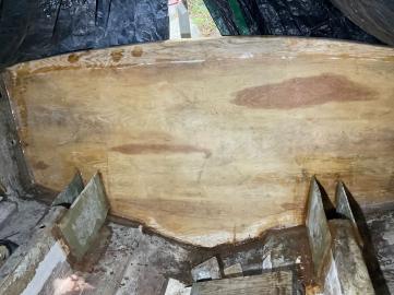

I made my first cuts into the original transom on March 9, 2009. The plan was to close the transom and add a bracket. In late 2020, I considered a cutout without a bracket, but adding back the splashwell was going to be as much work as a bracket. But I did think about it.
Transom is 2 sheets of 3/4 ply, inside face got 10oz cloth. Stringers (dry) were extended back to the transom. I added a small limber hole, so the water that collects outside of the stringers can drain. Hopefully I won't regret that.
I used 3 layers of 1708 and mat to fill the cut out. I should have gone with 4 or 5 layers, or just cut up one of the unused deck hatch panels. I put the drains about 8 inches in board, so they drain right on to the tabs. I spent a lot of time trying to figure out how to get the hydraulic steering cables and transducer cables through the bulk head, without spending $500 on cables. At one point I was about to order $1500 worth of thruhull transducers because I didn't want to put a 1"hole in the new transom...I ended up buying the uflex hytech kit because its beefy enough for the merc 150 efi (e.g. rated to 175 hp, unlike baystar), and modifying a Scanstrut Multi Deck Seal to get the 1" simrad tranducer through.

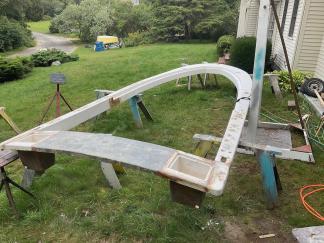

I recored the topcap with 1/2 ply, mat, and vinylester. I made the transom cap from 3 layers of leftover 1708 from the bracket. I stuck some extra 1/2 ply where I might put rod holders.
It turns out that the there is a slight crown at the bow. I thought I got this by not supporting that section when I vinylestered in the ply, but I should have measured the width at the anchor locker. Getting the topcap on was a bit of a clown show. It wasn't heavy, just awkward. In order to get things to fit, I had to jack up the bow a little, but was still about 1/4 off. Good thing 5200 is strong, and rubrail covers the gap.
At the transom, I forgot to consider that the new transom extends back a little (e.g. 12° lean back), so I had to cut the top cap lip and epoxy in some leftover strips of fiberglass. I think in cars they call this 'dzusing in a panel', anyway it worked.

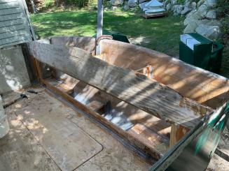

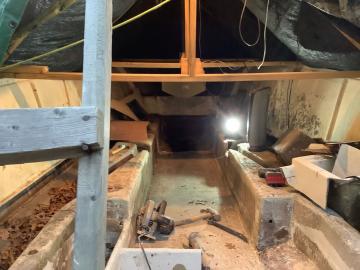

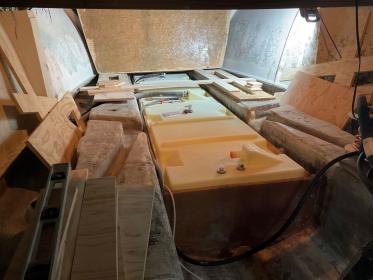

Default Gas tanks and Decks.
I decided to replace the original 110 gal tank (for twin 2 strokes) with two 55 gallon plastic tanks. The new tanks were taller than the original with 3 sides on the bottoms which were supposed to fit snuggly against the vee shape of the bottom, but because the keel was done with a section of PVC covered with heavy glass, the tanks didn't quite fit. Also, because plastic tanks need room to expand 3-5%, I decided to make a new tank cradle. The tanks can now breath a little but are not going anywhere. I also moved the livewell from in front of tanks to the leaning post, so I wanted to move the new tanks forward. With two tanks, I should be able to adjust weight distribution a little; I don't plan to make any trips burning all 110 gallons on a merc 150 efi.
The decks were raised 1.5" which I had planned to do with 2 by cedar framing, but the weird shape of the stringer convinced me to do it by laminating 3/4 ply. I left the inside lip from the original decks. Without that, I never would have noticed that the decks have about a 1/2" crown. The decks themselves got a layer of mat and vinylester on the bottom, and 10oz cloth and epoxy on top. A second layer of 10oz cloth and epoxy went on after the decks were installed.
I almost forgot to cut gas tank inspection hatches, but the original owner of chaser saw some early pics and sorted me right now. Thanks for that! Its worth noting that the original tank support was replaced at some point. 3/4 ply with a few layers of 1708, maybe 1808, it weighed a couple hundred lbs. After sitting with water pooled in it from 2009 to 2020, there was no water in the ply: I used it for stringers in the bracket, as well as tank cradle stringers.
