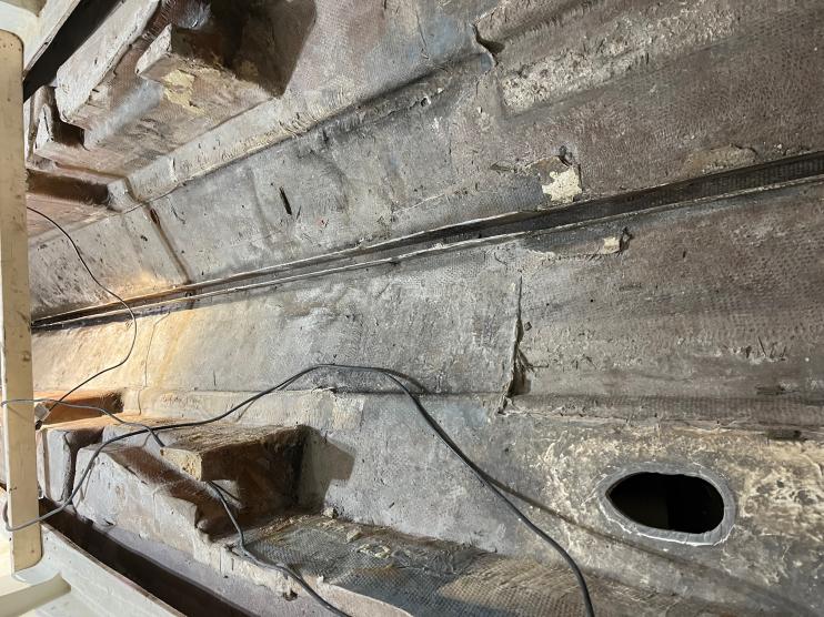

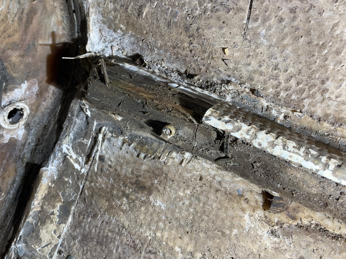

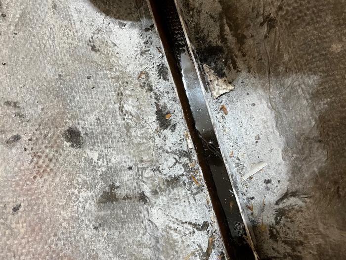

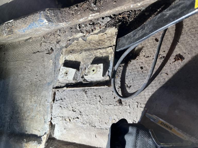

Finished up cutting most of the tabbing to get at the remainder ply in the bottom of the boat. The keel stringer is shot- you can see where it has been screwed into over the years.

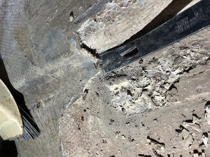

It seems like when they installed the I/O 2x6 motor mounts they layered the glass over the mounts, down the hull, over the keel and back up to the opposite mount. I found the glass on the sides of the mounts were delaminating with water in the bilge area- prying it and cutting it back it seems like it works its way forward in the boat. Does anyone have any insight to where this glass should stop? i don't want to pull too much up.

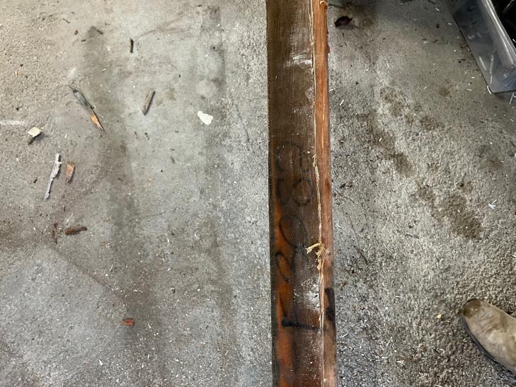

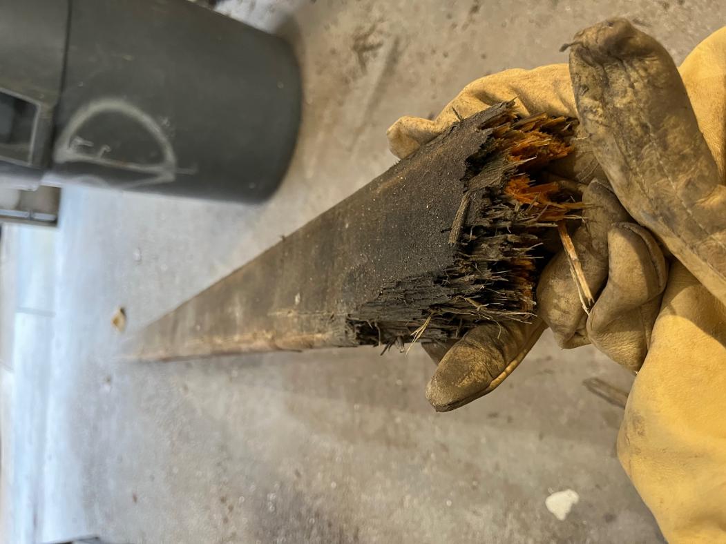

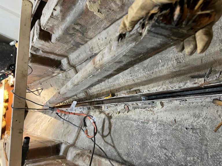

Keepin' at it. Took the old transducers off, they were mounted in a cup as part of the hull with a ton of putty. Keel stringer was completely shot, cool to see a part number handwritten on the side of it.

Thanks. My keel stringer is wood i removed a square from the top of it about 4' forward of the transom. Its wet stabbing a chisel into it you can see the moisture. Would you recommend the pvc keel stringer mod i have read about to replace this? I assume i need to beef up the layup on the keel when i am down in there.

More grinding today. The transom is cleaned up most of the keel stringer tabbing is gone- just need to grind the fillet flush. Pictures of the I/B cracking i have to grind back. More grinding to come
