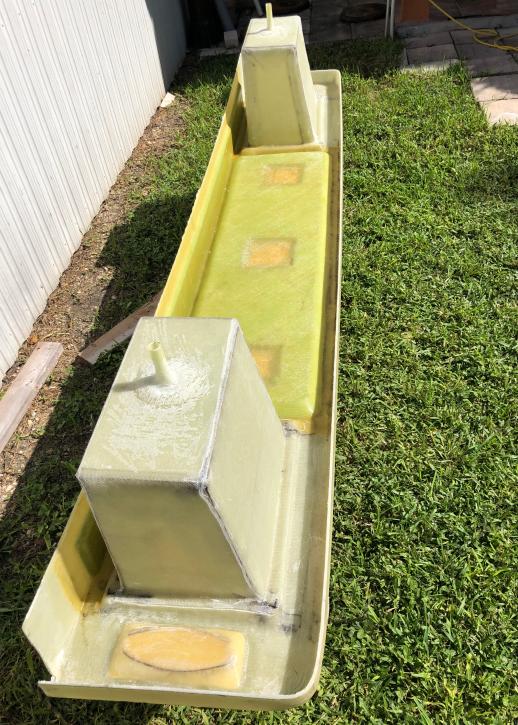

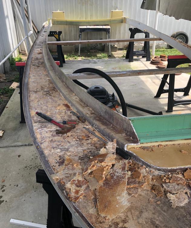

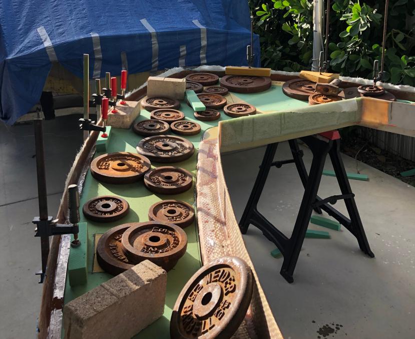

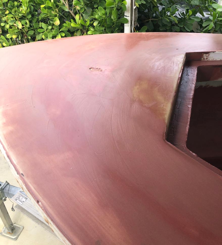

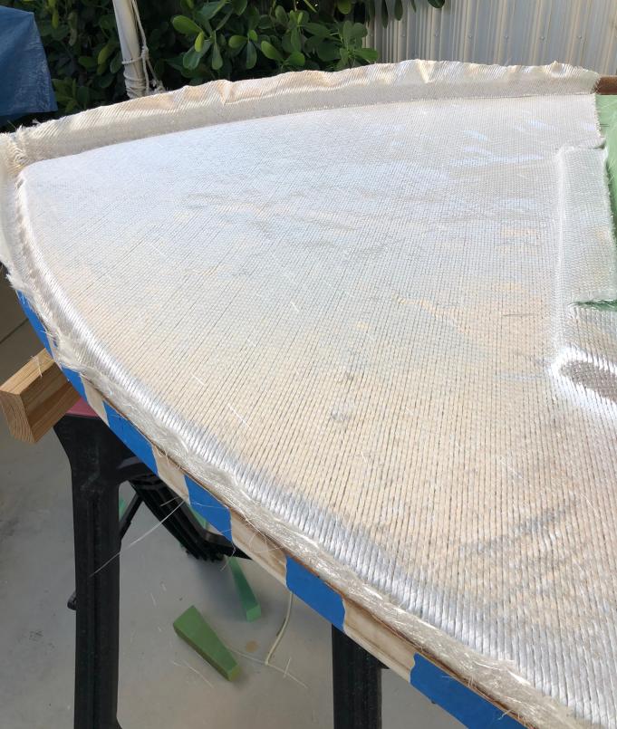

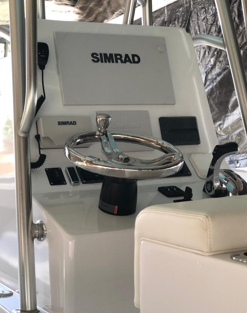

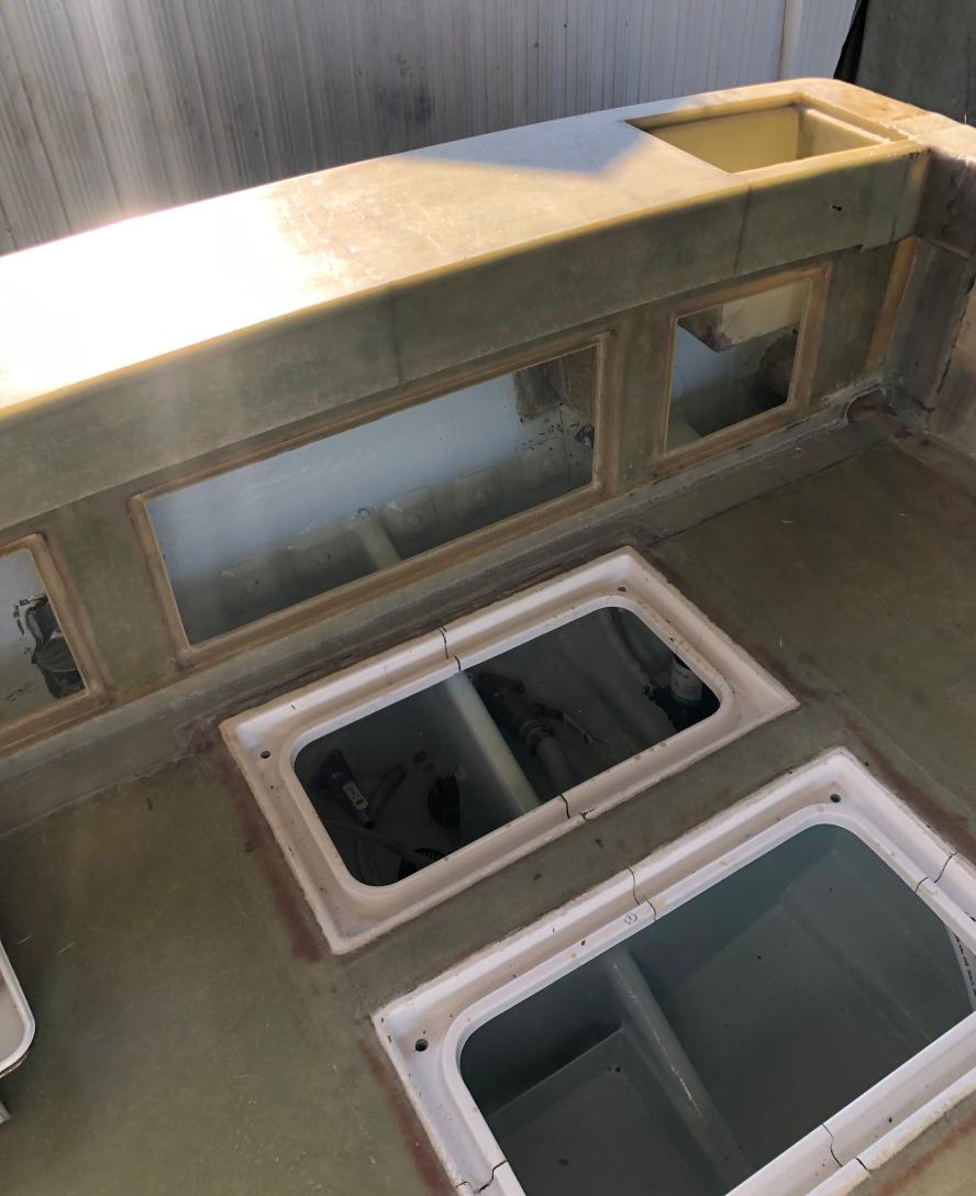

Two coats of Pettit Protect® High Build Epoxy Primer, touch up and touch up, sanded and sanded, two coats of awlgrip 545 all hull inside and outside, sanded again, blue ice on the sides, cloud white inside and on the cap and INTERLUX VC Performance Epoxy on the bottom, this one is not super glossy but it is super rock hard when dry and can be improved by fine sanding and polishing, the non skid awlgrip mix fine and coarse 50/50

pics

more
