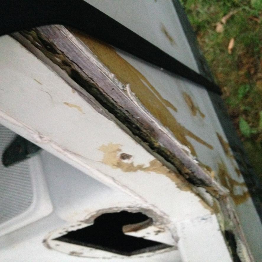

This is the scupper support area in my old 1972 seafari. You might carefully inspect this area . . . see the cracked potter putty. I removed the old bronze tubes and banged in PVC. I made custom plugs for the PVC. I also like the idea of a transom mounted engine over a bracket.

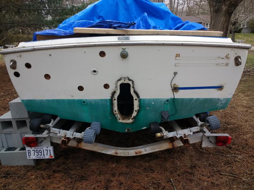

Thanks everyone. I did a lot of reading last night on here checking out completed projects Still plenty more to do. I think the notched transom is the correct path for me to follow. Dealing with CG shifts, a bracket, etc. will be saved for the next all-in project.

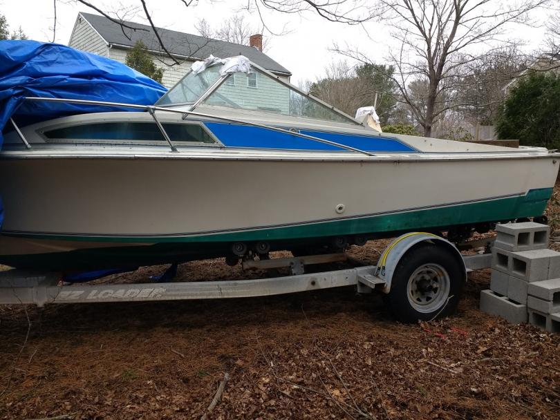

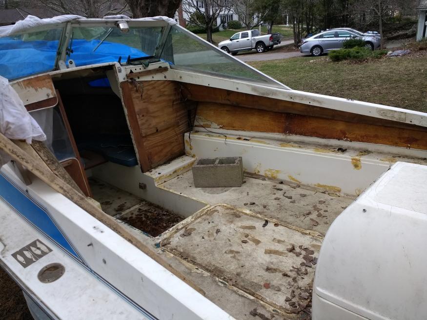

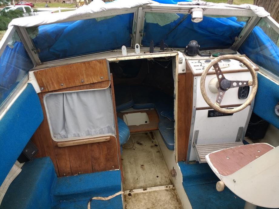

Off to a good start. In addition to the transom, the deck needs to be replaced. It is soft in a couple of places there were screws. A whole new deck makes sense since the engine opening needs to be done as well. I think this will be a good opportunity to move the fuel tank forward and make it larger. TBD.

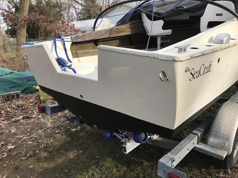

It is funny going back and reading some of my original ideas. I am very glad I listened to the advice offered and kept my Seafari intact. I can't believe it has been four years. Covid really screwed things up for a while. Last spring I really got back into it and now that the winter break is almost over and I am getting back out there it was good to have some inspiration from this old thread. Fingers crossed this summer she will be back on the water.
