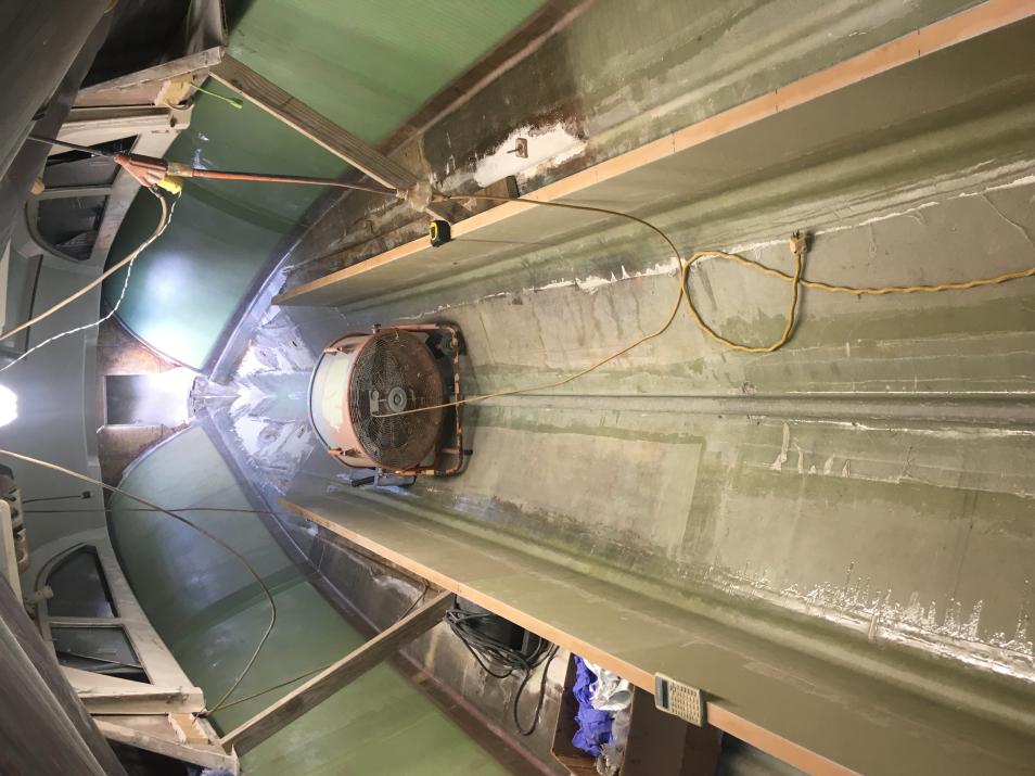

Lots of grinding, lots of glassing. Keel and main stringers are in. 2 layers 1700 in bottom, more in the keel underneath stringers.
The original keel stringer was set in midway thru the main hull lamination so it was pretty thin underneath it (actually had been worn clean thru in some spots on the bottom).
The other stringers were set in after the hull was laminated then wrapped/tabbed in so they were a bit easier to deal with.
Shes giving up a fight thats for sure!
Coring hullsides next then onto bulkheads.
Im no artist, the transoms a bit wonky but you can get the idea...

Bulkhead and tank time. 200 main on centerline and 50 each in saddles. 70 gal of freshwater just behind main bulkhead...

You said that this was a back burner project which for me means years but you are hardly 6 months into it and it looks fantastic and is indeed inspirational. My 27 is almost on it's way to San Diego and I'll certainly be following your progress.
May I ask why you cored the hull sides and what material you used? I see that you overlapped the new section but you also went forward too. Do you think there are benefits to coring the sides on a factory 27?
