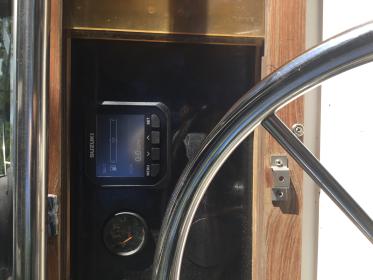

Posts: 612
Still getting boat back together. It sure came apart a lot quicker, but then I am trying to clean and paint. Having an issue with the smg4, not reading fuel in tank. From what I have read and what the motor salesman told me that the gauge should come up when I put gas in. Motor guy put 10 gallons in and I added 40.

So I cleaned up the nest of wires. I ran the steering hoses through the hole in the shelf along with the throttle and shift cables as they have been since I bought the boat almost 30 years ago.
My original plan was to put the gps puck (point 1) that came with my motor gauge on top of t top. I don’t think the cable is long enough to reach the top. It seems to work sitting under the console. I was thinking about mounting it to the top of the console. Any thoughts?
