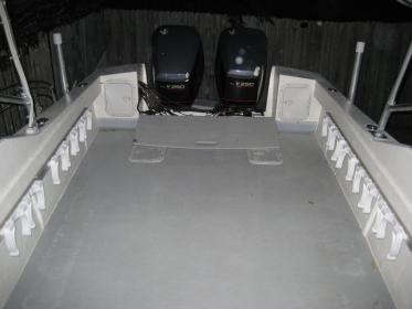

No bracket, batteries and fuel forward, twin 250 OX66 on my Tsunami. Pros: fast and sexy. Lighter than a bracket boat with twins by far. Able to achieve chine walk in about 10 seconds. Cons: Tabs required for every aspect of running. Backing down in seas not advised. Everyone on board rides forward to keep boat on plane in seas.
