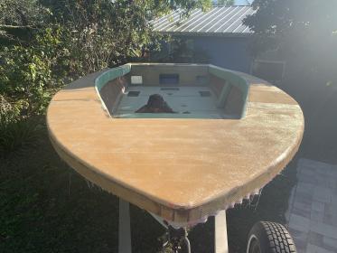

To build the cap, I clamped a sheet of foam to the bow, and traced out the shape of the bow piece. After I cut that piece out, I clamped it in place and worked down the sides using the same technique. I fiberglassed the undersides of each piece outside the boat. I then installed them and taped the underside of the joints together. This step had lots of vertical and upside-down glassing (gunnel to hull joint), which is not fun.
With the top installed, I built a 6" deep inwale using the same technique. At the bow, I took the inwale deeper to create cubbies which makes a good storage spot for shoes, towels, clothes, etc.

I also installed a strip of foam to the outside to attach a rubrail. I fiberglassed the cap, hull and inwale together. At this point, everything in the boat is one-piece (monocoque) construction.
Since I filled in the transom, I had a little more than 1/8" gap where the original cutout was. I ordered some 1/8" Divinycell to fill this in and built it up the rest of the way with 1708. At this point in the build (2 years in), I was getting to the point I wanted it done. So we will say that my fairing of this area left a little to be desired.
