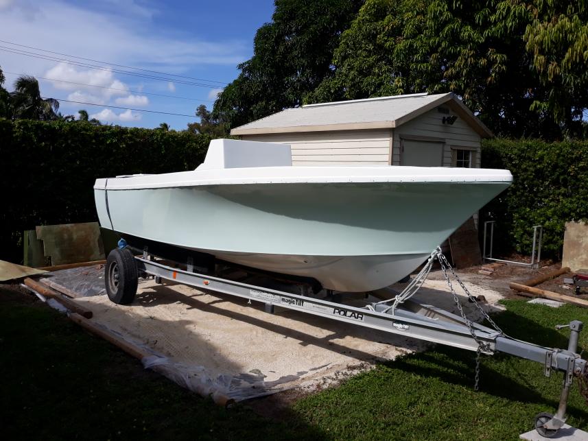

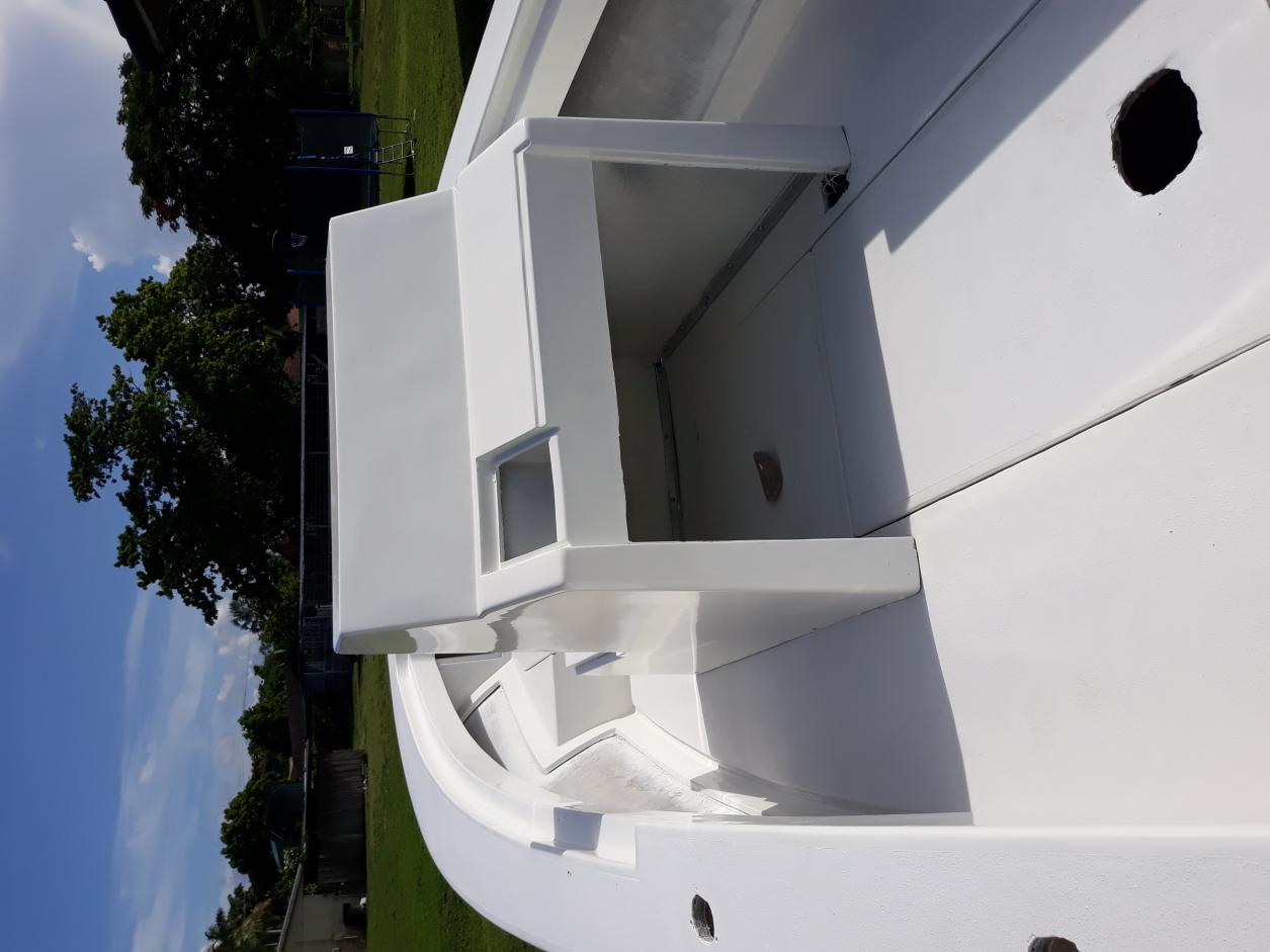

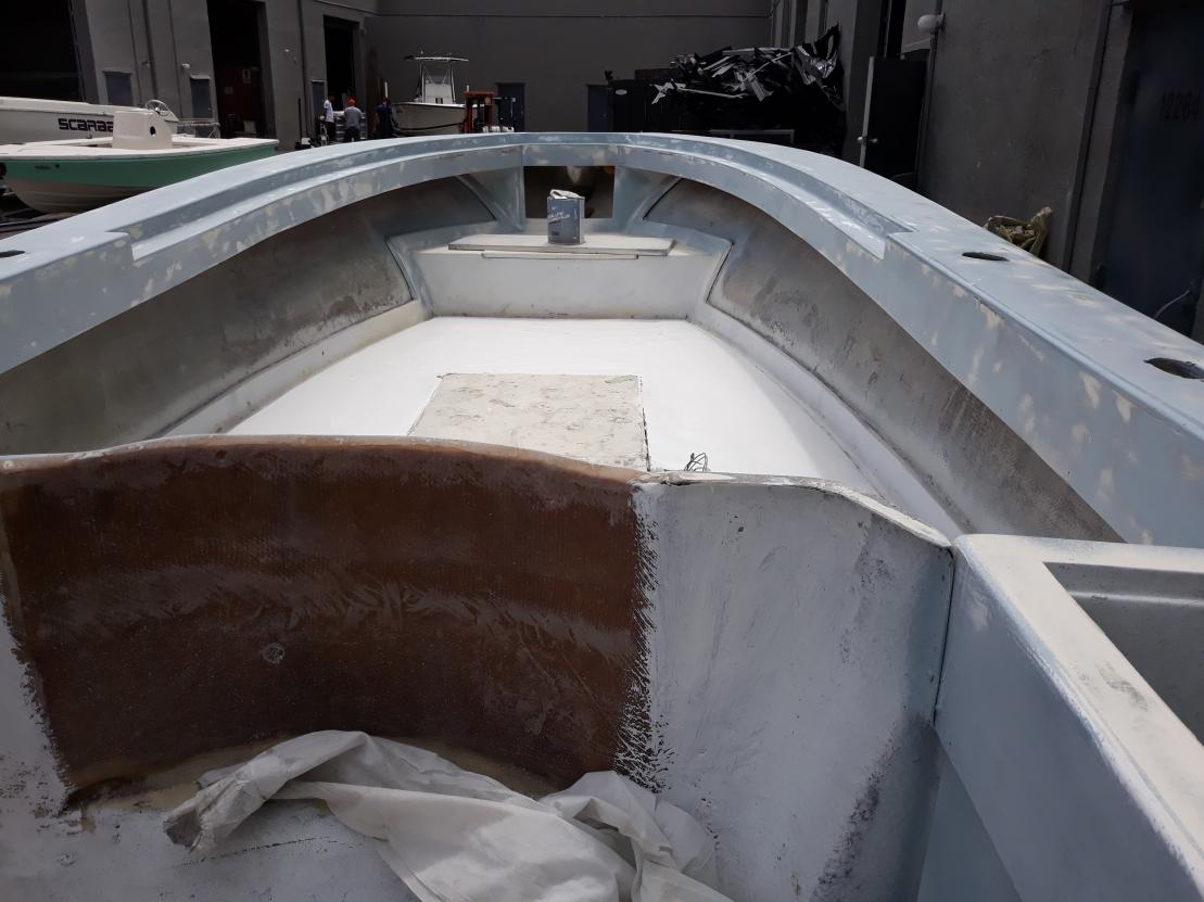

I decided to move my progress on the build to 1 thread
Here was the boat after I replaced the deck with nida core, replaced the transom with array and took off the cap took out the wood and replaced with nida core along with recore of gas tank cap.
Days after I took it to a glass shop to finish and paint it with aqua mist awlcraft
  #113
Old 08-11-2019, 07:20 PM
It took a little over a month but I liked the results

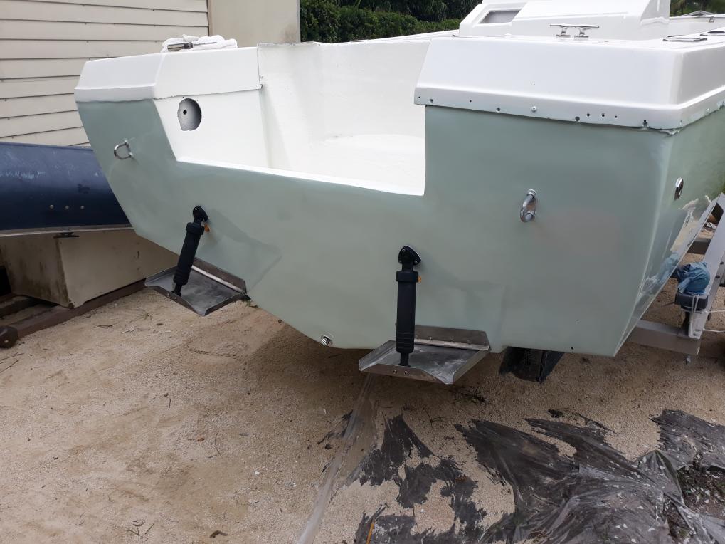

With the heat and the rains I was able to get some small but steady progress
Started with putting back the rod holders and bright work each day I was able to get over to the boat.
Installed the trim tabs and today I took out the rub rail and "rehabbed " by taking a rag and some mek that saw on the internet a d they came out pretty good. I'm going to install them tomorrow.

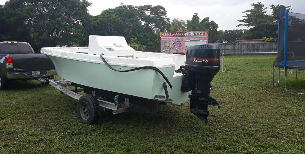

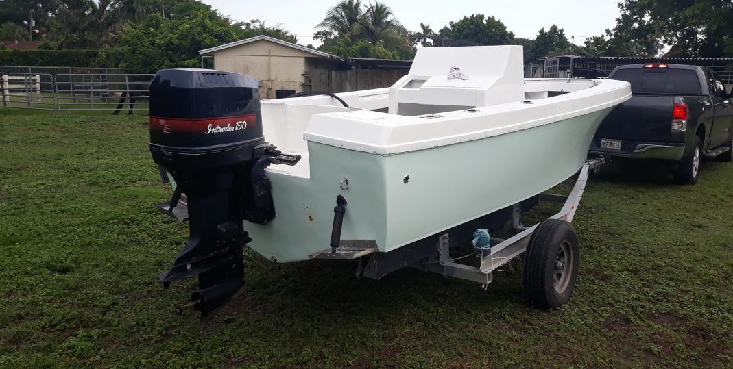

Had so.e time today in between the rain and my favorite brother in law to help and I went and hung the engine. Did nothing but put it on with no rigging.
I need to extend the engine from 20 to 25 inches, thinking of using I think it’s a bay star product
Next is the rub rail
It's starting to look like a boat

Been following your thred...nice work! painted my 23cc that same color...looks like there is a horse in the background?
  #120
Old 08-27-2019, 11:22 AM
its my mother in law's house. they have lived there since the early 70's and my brother in law has 5 Paso Fino's and 1 was was just born a couple of weeks ago.
