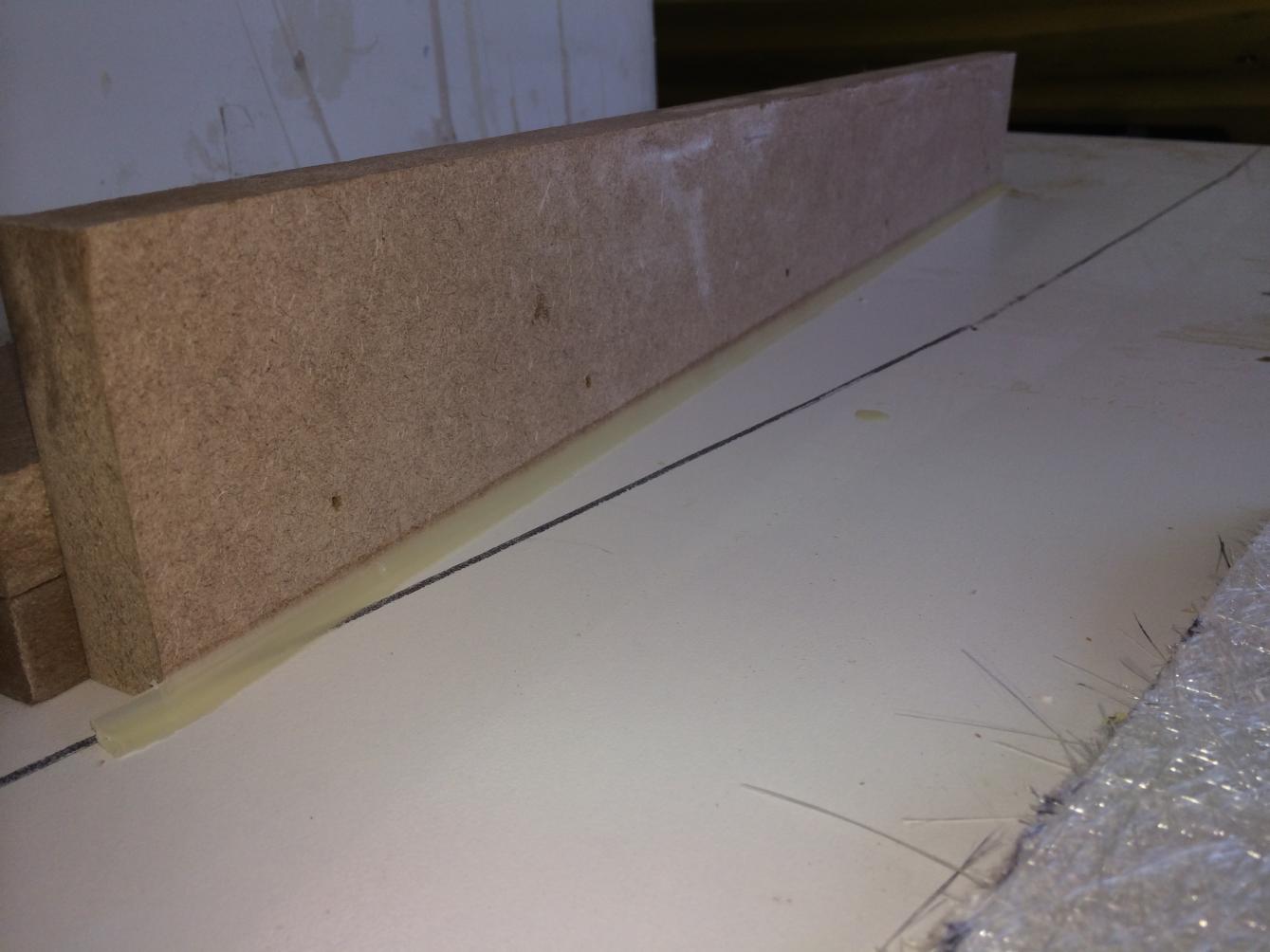

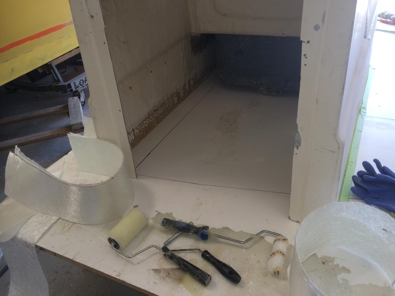

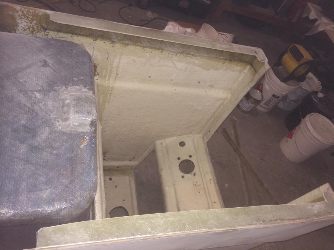

today I started will laminating the flange on the inside of the console. I layed up 2 layers of mat,1 layer of cloth and a layer of 1708.
the second pic is of mold I made to make the fiberglass angle for the front of the console to mount to.
then I turned my attention to the hatches and ran the router around them and trimmed about a 1/8 of the old flange off to get rid of the chips and cracks in the existing.

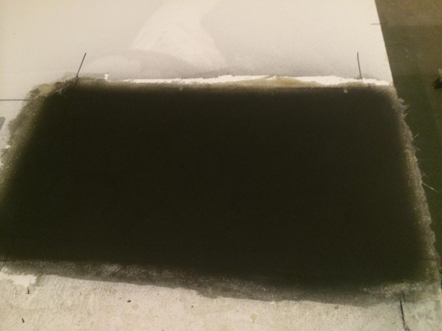

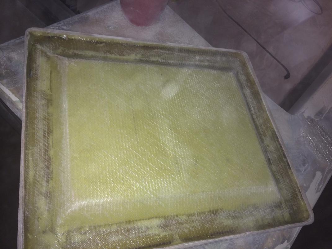

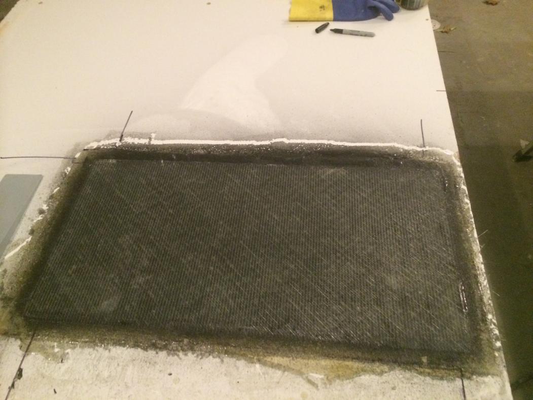

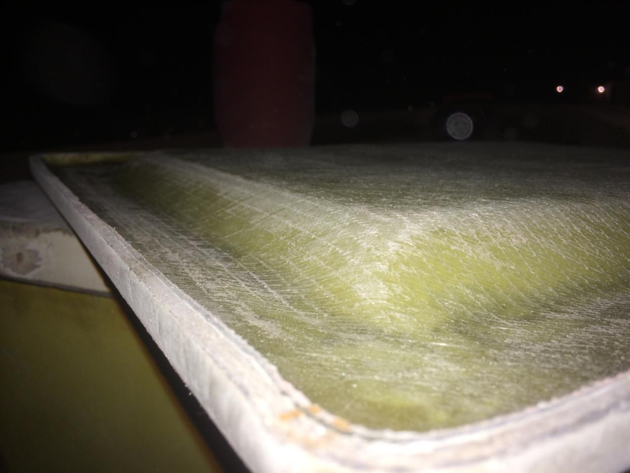

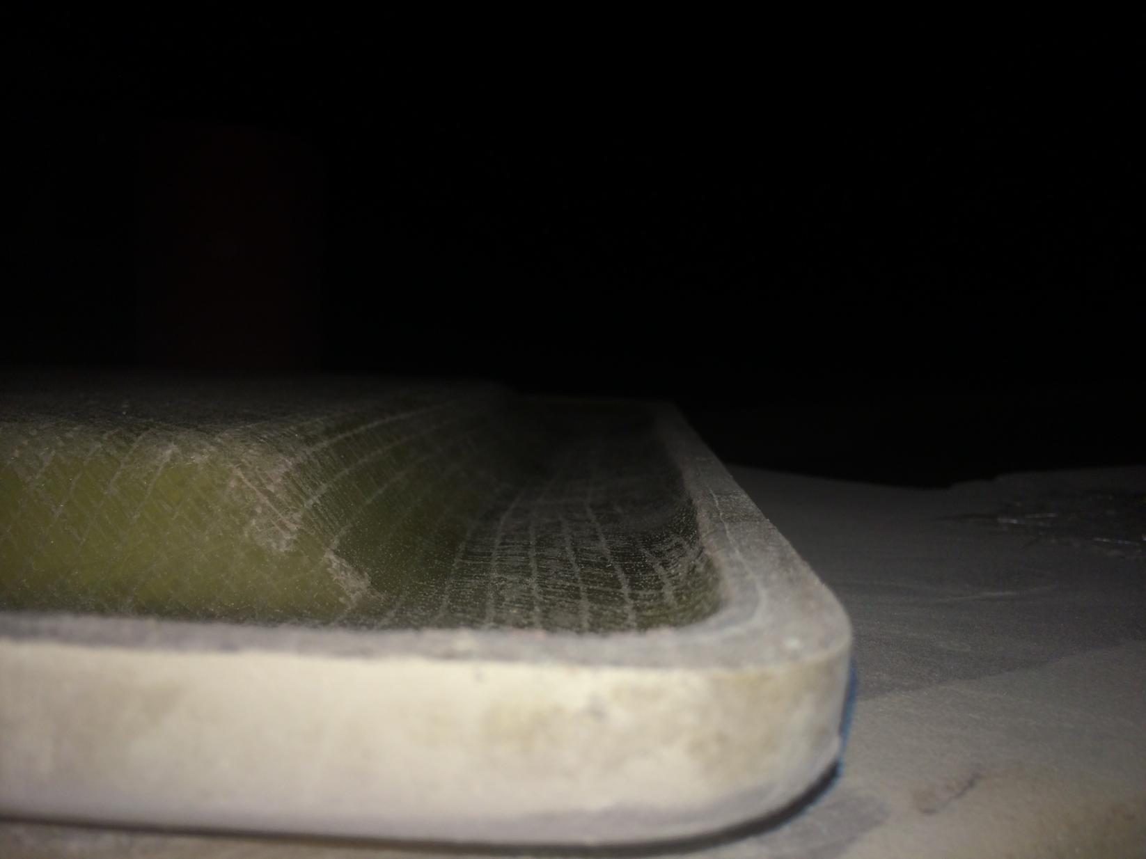

I decided to mount the electronics on a black gelcoated panel. I marked off an area on the melamine and I sanded it down to 320 and waxed it , I sprayed the gelcoat down and let it kick, then 2 layers of matt dry, 1 layer of mat and 2 layer of 1708, I then added another layer of mat and a layer of stitch mat to stiffen it up.
I popped it off and gonna cut it , wet sand and buff. should look good

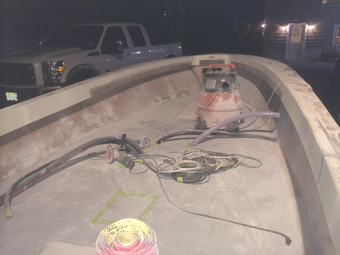

then the time had come, it was time to push the boat outside and do some grinding for about 3 hours into the dark. I was as bad as I remembered and if I have to do it again it will be too soon.
it is now done and time to finish the tabbing in all the way around.

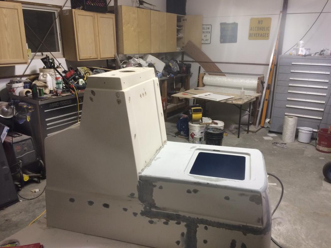

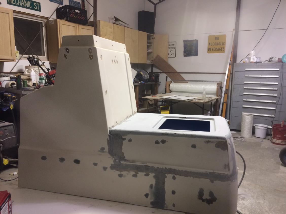

alright got the hull to deck tabbed together with a layer of mat and tape.

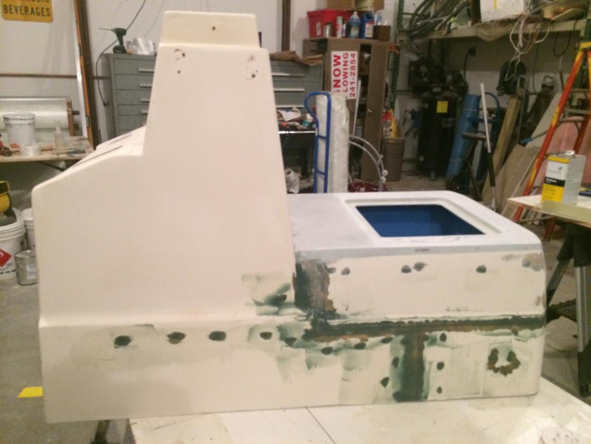

I then went to work on sanding the console after filling all the holes and seams with dynaglass.
I also shaped the livewell top by hand with the sander. got some more small holes to fill then one last coat of easy fair and it is ready for primer.
