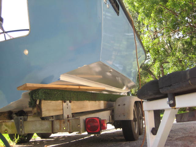

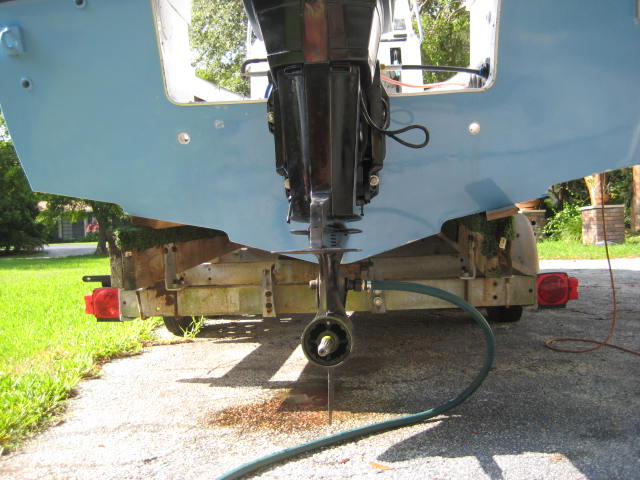

Bought the selenoid and the trim fluid and got the trim working
One more thing off the list.
Next is the trailer
The boat rests more on the rollers that are down the middle and not on the bunks
As you can see in the pics I placed some 2x4's to steady the hull
I would like to move the bunks inward or raise them so that the hull rests on them and if possible eliminate the rollers the rollers will get in the way of the thru hull.
After that;s done I have an appointment with the mechanis to take cate of the leak in the lower unit, but while that is done I need to run power to the bilge pumps
Either way it needs some tuning

you will need the rollers nearer the front so it doesn't scrape - it should almost float over that rear one launching and loading?
I agree it needs to be mostly off the rollers at rest

what year is that trailer? Looks like "old roller" The fenders give it away.
