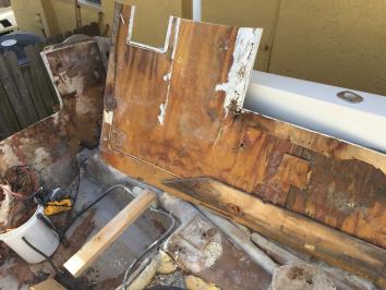

I re-read this thread again. You are doing a great job on your bottoms up !
I would like to backup a bit and clarify a question I have. You stated your SeaCraft is a 1986, yet the alum fuel tank you removed was dated 2003. What happened that caused the original fuel tank to have to be removed?
Was this hull previously rebuilt?
Thanks for the compliment. When I bought the boat, the guy advertised it as having a new deck and tank. When I went to see it the deck was delaminated and rotten. The transom was shot. The guy told me it fell off the lift and was left in the water. Looks like a D ring had pulled through the rotten transom. He said he paid a friend to fix the boat. He did a really bad job. No sure why the tank was replaced. I think it had twin 140 Suzuki motors. They were long gone. In this pic you can see the plywood that was put down as the tank was replaced.
  #157
Old 07-22-2019, 07:42 AM
There is an old saying "Buyers are Liars but Sellars are worse". Based on your pictures along with the degree of total deck delamenation, I would bet that the hull was submerged at one time which supports the tank removal and wet foam.
Keep up your rehab. Another ole sayin "Get Crackin Kraken"

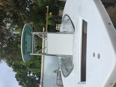

T-Top day!

Let the rigging begin. Run rail on, fuel done, steering complete. The leaning post even lined up on the aluminum plates under the deck. Still need to finish the plumbing and get a basic electrical system installed to get the motor hung.
