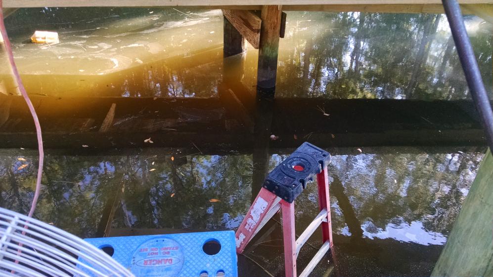

Well after a long debate in my little brain I decided to make a lexan template and trace the pickup on the bottom of hull... Measured carefully from strakes to make sure we are somewhat parallel... Then I took my calipers and measured the thickness of pickup and strainer..set my router and off I went carefully taking a little by little off and trying to keep it within the lines..I found muscles I did not know I had in my shoulders and legs. As I was upside down ,on two ladders in the water, routing 38 year old glass.. All while the tide was coming in.. Fun fun fun... Now that is done I mixed some west epoxy and sealed.the glass... I did take the glass down just under flush about 0.410 ".the part measured 0.360" After epoxy sets up i will go back and route to 0.370" or close to... I wanted to leave the glass sealed up..
