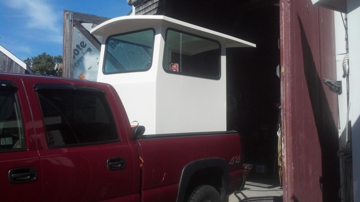

Default Pilot house showed up yay!!!
just picked up pilothouse today looks good

Old 09-20-2012, 08:40 PM
Where does the fly paper go in that Pilot house Looks Great!!

Location: Dennis, MA
Posts: 394
lol I know its big but had to cover engine with it

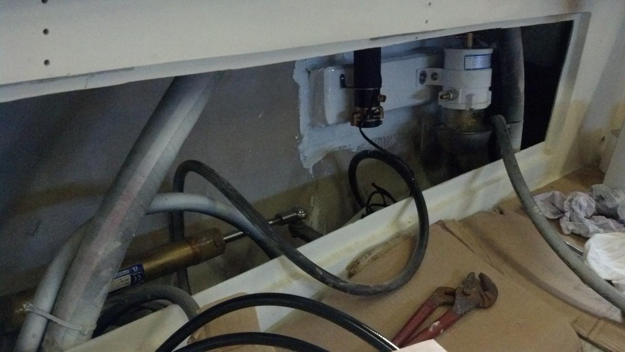

Posts: 394
few more things done with little time to play starting to look like something

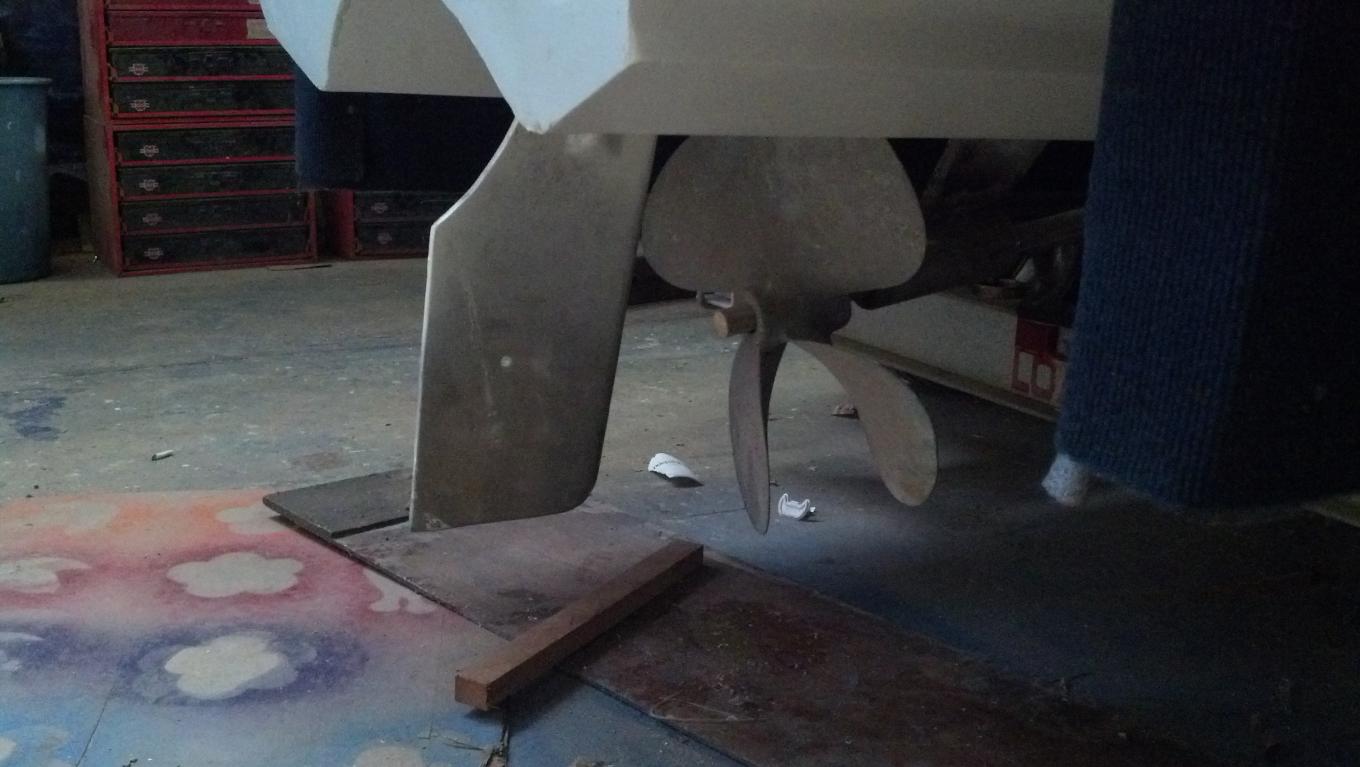

Default 23 Inboard
That looks like one big ass wheel, I hope you got some proper advice on the combo. When is this this scheduled to hit the water? You must be chompin at thebit. Todd

Posts: 394
lol the wheel is just one hanging around its a 19" im going with a 17x20dqx and yes i am at this rate i'll be ice fishing her
