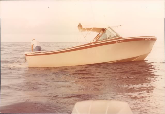

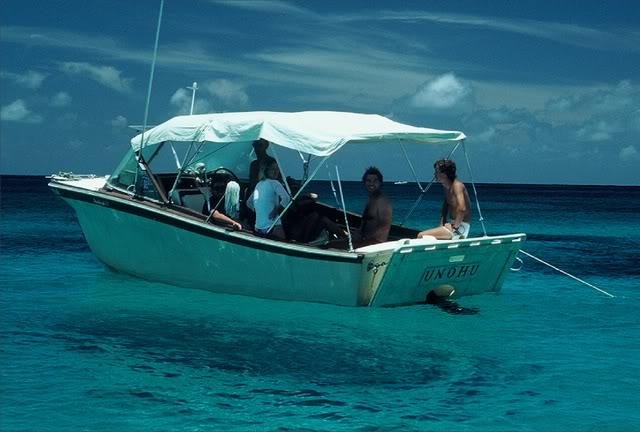

Here's an excerpt from a recent e-mail from a good friend of mine that bought one that was on display at the 1965 Miami boat show:
". . .When I still had the original 230 cu. in. straight six Chev Mercruiser @ 150 h.p. I crossed to West End once in 8’-10’ at 2600 PM. Took 5 hrs. but NOTHING rides like that 21 – NOTHING ! – Carl’s “secret” was the patented Variable Deadrise. There was a 23 Allmand with me. Every time I looked back to check on him, either his bow was submerged or he was airborne! Like I say – NOTHING ! – Once, returning to FL with Everett I took a 20 ft. “rogue” wave when the USCG stopped us “out in the middle.” Beth was hysterical for about 10 min. or so. Every time I see the film, “The Perfect Storm” I have a flashback to that incident. I just had time to tell Beth: “HANG ON !” But, we took it. -- I could see “daylight” through the rim of the wave. It was just about to “break.” USCG guys who finally boarded my boat to look for drugs, said: “Yeah, we saw it. – That was a BIG wave!”
NEVER – not EVER did I take a wave over the bow of that boat – and I went out in ALL kinds of weather when I first came down here.
Until Craig taught me: “Bob, it’ll still be here next weekend – we’re goin’ home.” I was afraid the Gulf Stream might leave! After that, my rule was: With my eyeballs 6 ft. above sea level, if I can’t see what’s right in front of me, I don’t belong out there ! – Another “rule” was, if a wave came over the side and over the gunwale into the cockpit– we’re outa’ here !
Once I lost a STUPID diver out there in 10 -- 12 ft. seas, and went to USCG to help find him. They paid Carl Moesly and the 21 the HIGHEST compliment EVER ! – The USCG Bos’n asked me if we wanted to go in my boat or their 28 ft. boat. I could tell he was scared, but I said I lacked the proper radio equip. to commo w/their chopper. We went out, but no sign of the idiot. CG chopper found him later, hanging onto the channel marker at the L.W. Inlet."
Bob may be a little biased after running that boat for 29 years and literally wearing out about 4 engines, but he has more experience with it than anyone else I know of, including about a hundred Bahama trips. He's definitely "been there, done that"! Denny

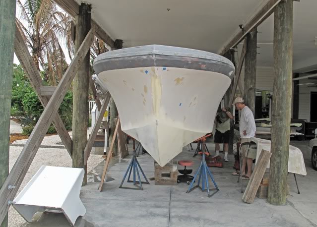

The Moesly 21 is the grandaddy of all SeaCrafts, the very first production model, designed and built by Carl Moesly in Miami in the early 60's. Many stock 21's were raced in the very rough Offshore Power Boat races in the 60's with twin I-6 Mercs, totally dominating the outboard class and often beating many of the bigger inboards running 1000 HP! Check out Carla's Moesly SeaCraft site for more info, http://www.moeslyseacraft.com/21-seacraft.html. Be sure to also check out the Stock Boats section under the Racing tab.
Although deadrise at the transom is about the same as the 23, the steps are much deeper and deadrise in the forward sections of the hull are much deeper than the 23, very similar to the 25' Seafari. As a result it's probably one of the best riding of all the SeaCraft models, except maybe for the 25' Seafari, with it's 24.5 degree deadrise at the transom.
Bob made many crossings to the Abaco's across the shallow Little Bahama Bank which is notorious for short steep square waves. Many 23's made that trip with him, but he said every time the seas got over about 3', the guys with the 23's would start calling on the radio, asking him to slow down! (And he didn't run that fast, typically cruising about 20 kts.) I've ridden in both the 21 and the 23, and I'd pick the 21 over the 23 anytime! It's ride is amazingly soft and I'd never worry about it pounding. Notice that you ride up forward SITTING DOWN, which to me is the true test of a good riding boat! That design would never work if it pounded! Riding in the back of a boat, standing up behind a CC with your legs absorbing all the shock, is not nearly as good a test of it's riding qualities!
It's definitely a rare boat - Carla thinks less than 200 were built. Only CSC members McGillicuddy, Island Trader and 3rd Day have Moesly 21's. Brian (3rd Day) also restored one that he traded for his 27, probably has most rough water experience with the 21, and can probably give you a better first-hand testimony of it's riding quality than I can. He was so impressed with it's ride that he was talking about popping a mold off of the one he salvaged down in the Keys a couple years ago, but don't know what the status of that plan is these days. Denny
