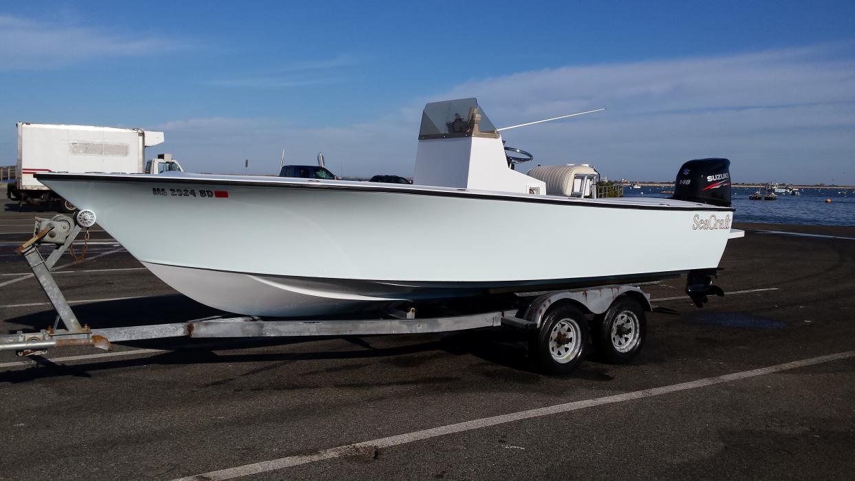

Nice looking rig and good choice on one of the lighter 4-strokes where weight is critical with a bracket!
". . . The Piston in the # 3 cylinder got water intrusion through the water jacket and there is a dime size hole in the top of it. . . . "
This comment got my attention, as a hole in a piston is often the result of detonation, which you can't hear on a 2-stroke since there are no valves to rattle! Detonation/pre-ignition can often happen with hot-burning lean mixtures, which could be caused by either a plugged jet/injector or a restriction in the fuel supply. Did anyone check the No. 3 injector on old motor? Something like a stuck anti-siphon valve at the fuel tank could cause a similar problem on the new motor! Hopefully the dealer installed new 3/8" fuel lines and T'd a vacuum gauge into the line between boat fuel filter and motor to measure fuel restriction. A vacuum reading no higher than about 4" Hg @ WOT is probably ok, but might be worth checking to see if Suzuki has a spec for that!

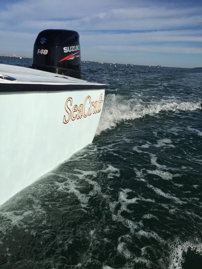

Thanks for all the comments. Like I said before much of the credit on this build should be given to this community and it's extremely talented individuals who have posted and shared thier ideas. The pictures and step by step tutorials really made this happen for me. Upon completing this project I stood back and realized it's missing one thing....It needs to proudly display the CSC 1970 Potter Hull Logo on the stern. I remember seeing them for sale here but for some reason I can't find them. Any help would be appreciated..

which prop are you running 14x20? I am gonna try to run a 14x22 labbed powertech to see what I can get out of her.
boat looks great and so do the kiddos.

Default Specs
1970 Sea Craft MASTER ANGLER
2014 Suzuki 4 stroke
ICE BLUE/MATTERHORN WHITE algrip
Coast Wise Marine custom flotation bracket
Custom full transom (Surf Marine)
Lenco trim tabs
Seastar helm with stainless wheel
Blue seas waterproof switch panel
Dual batteries with isolator switch
35 gallon moller polly fuel tank*(mounted forward under deck)
14 gunnel mount rod holders (4 tuna swivels)
All around recessed stainless hardware (cleats/navigation lights)
Pro Blaster Saltwater wash down
Birdsall leaning post with tackle storage
Taco rub rail
Electronics
Northstar 6100 chart plotter (radar /sounder capable)
Furuno 582C sounder with high speed 20° transducer
Standard 1700 VHF with GPS and DSC
Sony marine stereo with remote
12 v port charge
I pod adapter port
Materials
20 gallons resin
1/2 roll biaxial mesh
2 gallons duraglass
2 gallons awl fill
2 gallons awlgrip primer
Tons of other stuff I'm forgetting...yes its a sickness!!! The only cure at this point is starting another one..

This is my favorite boat! I hope mine turns out half as nice. What is the setback on that bracket?
