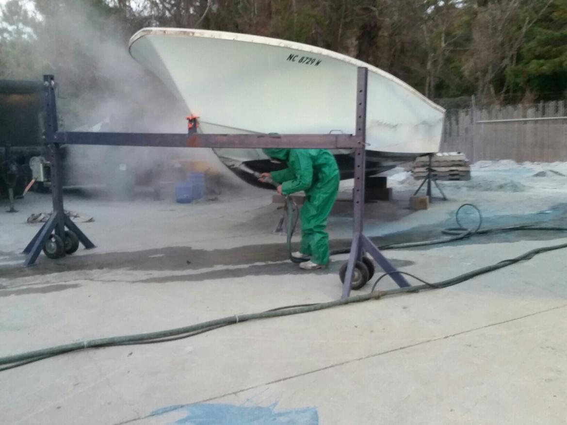

We got the whole interior cut out and cleaned up, ready to start tank bed and floor. Decided to Farrow blast the bottom paint. Bottom is in excellent condition. Fix a few small chips, sand and high build ready for finish prime.
Should be moving along faster now.
