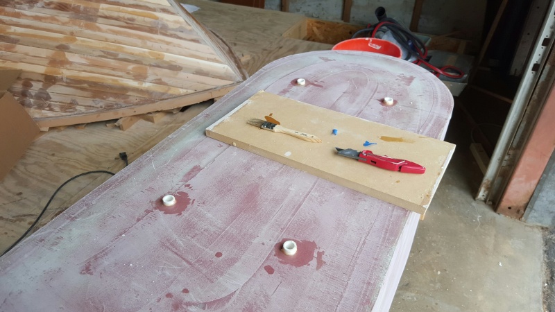

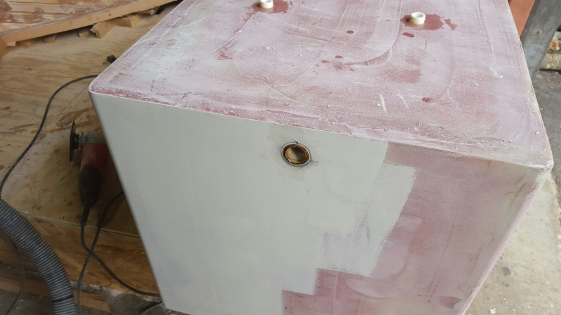

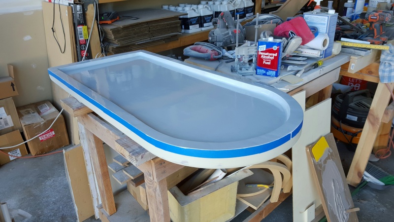

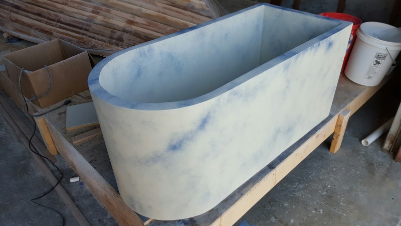

more primer, more fairing. *PVC epoxied into the bottom for the mounting bolts.

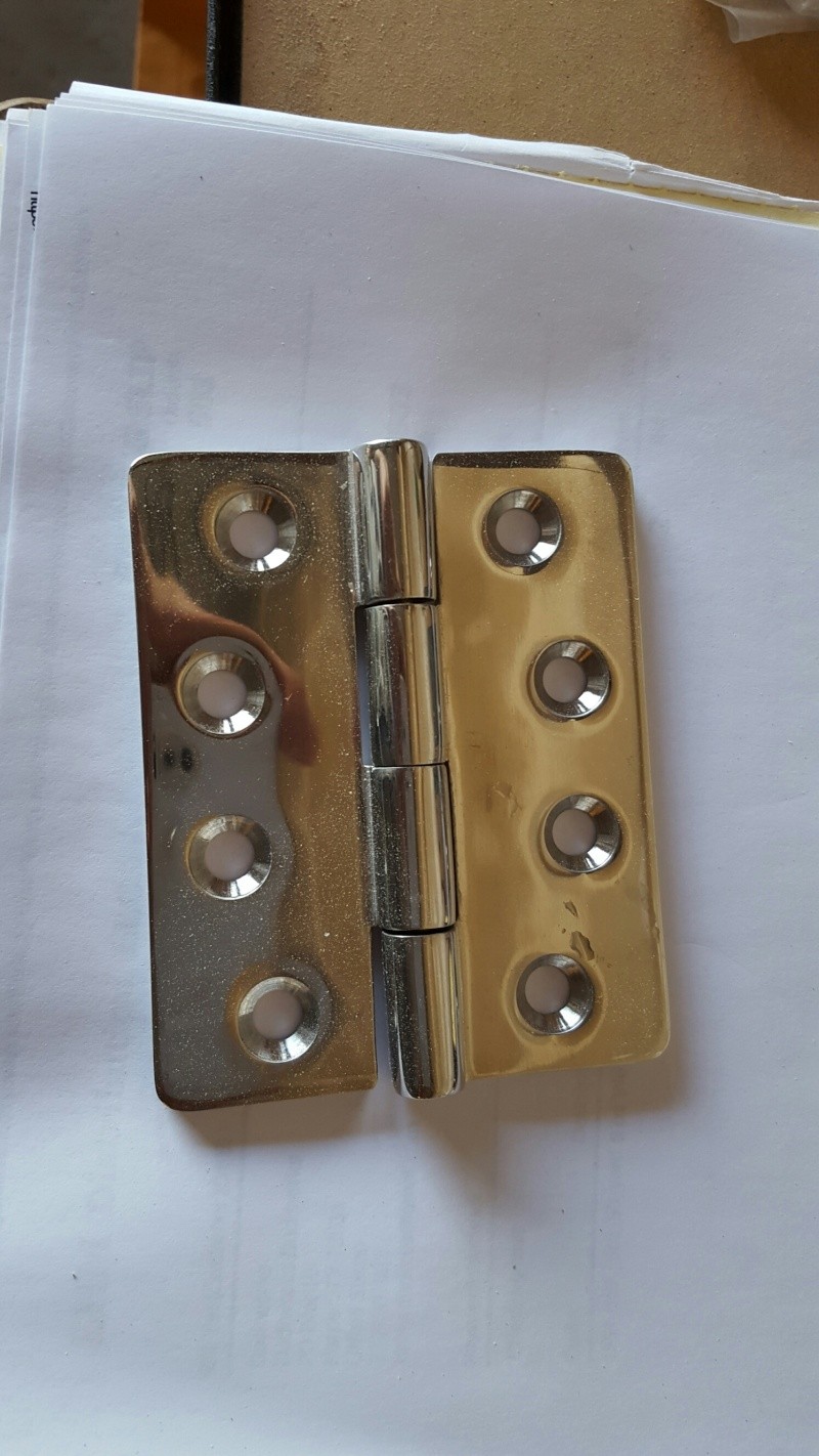

using the same hinges I used on the last coffin box, super heavy duty and rounded
Using EMC highbuild primer, it sure fills and builds fast !
link to the primer: http://www.gulfstreamcomposites.com/...mers-s/126.htm

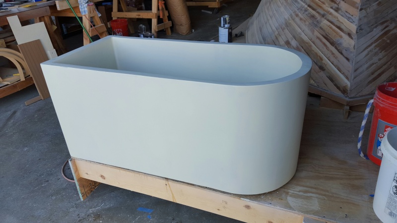

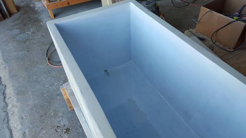

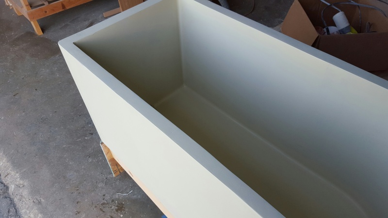

Another coat of EMC highbuild primer, then today the first two coats of Matterhorn White on the inside of the box. *Picture shows only the first coat. *Second coat gave full coverage. * The guide coat is just some spray paint, it lets you see where you need to sand and keeps you (hopefully) from sanding through. *Actually, I did sand through in some spots on the inside, but the paint covered just fine. *Paint is rolled on (no tipping) with a cigar style roller. *I used no reducer and it laid out like glass.

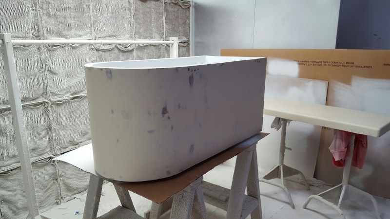

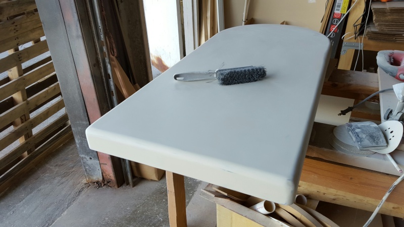

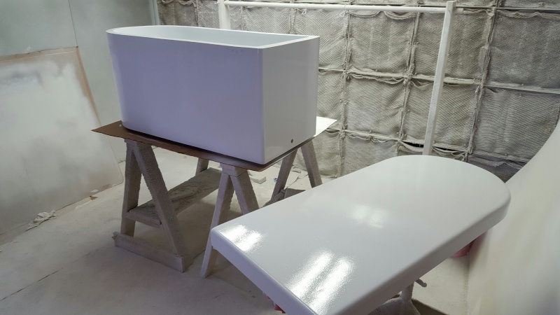

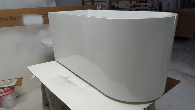

sanded outside of box to 220 grit. *Used my neighbors spray booth just to keep dust off, rolled a couple coats of EMC Quantum paint on in the booth. *Used about 1/2 quart so far and covered about 56 square feet with two coats. * *I need to put a coat on the boattom of the box, and I may put another coat on the inside of the box, but besides that I think the painting is done. *The guy I am building this for wanted a non-skid pattern on the top, so that will happen next week after I install the hardware and gasket
this picture was taken right after rolling the paint on, it is in the process of laying out.
This is after about 1 hour, all tightened up and dry to the touch. *
