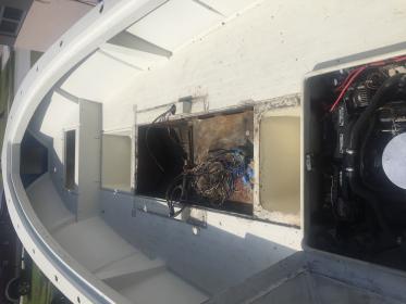

Posts: 139
I still do t know how to add multiple picture from My phone. Stripped bare

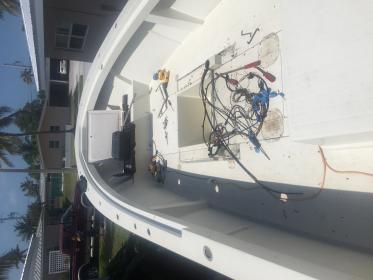

Old 03-27-2016, 09:57 PM
Join Date: Sep 2015
Posts: 139
Even more bare

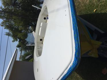

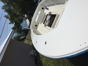

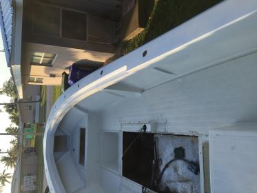

Default Progress
It's coming together. All the holes have been filled and smoothed out and now it's primer time

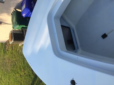

Posts: 139
More primer

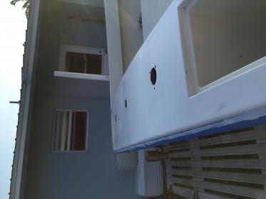

Posts: 139
Default Top coating the cap today
Still don't know how to post multiple pics

Default More topcoat
2nd coat
