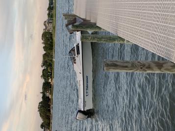

I have 300hp Etec G2 on 23’ WA. EXCELLENT wot 5900rpm 46 mph, 4800-40mpg 2.8mpg, 4000- 31mph 3.2mpg. Should probably add 1” pitch should improve cruise speed/mpg
Old 10-30-2019, 05:50 PM
Nice set-up. What's the normal redline on your motor? What mounting hole?
