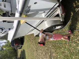

Found some. The clam shell covers the front third as a deflector.

Thanks for the pics. I may start with the clam shells and keep the rubber flappers incase I want more protection.
