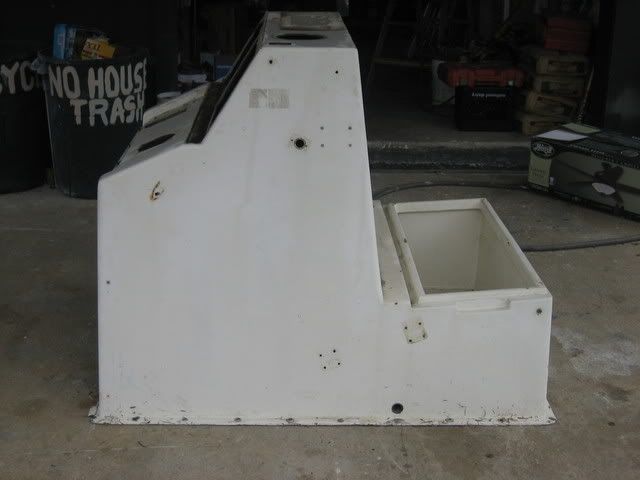

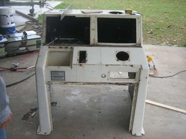

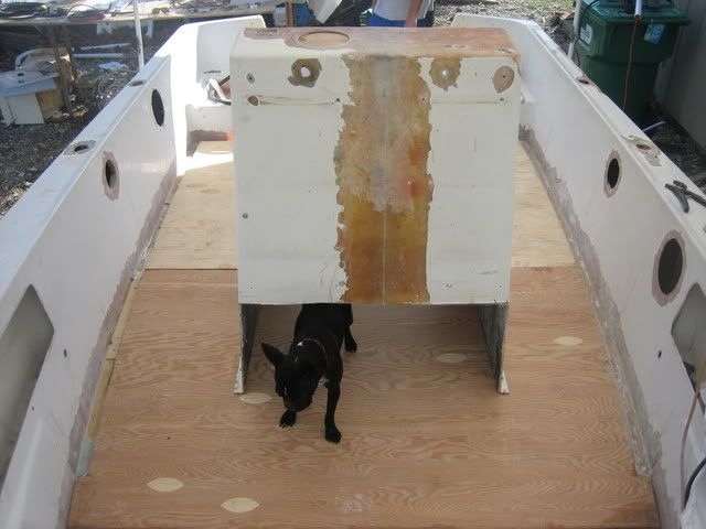

Here is the start of the console modification/refurb!

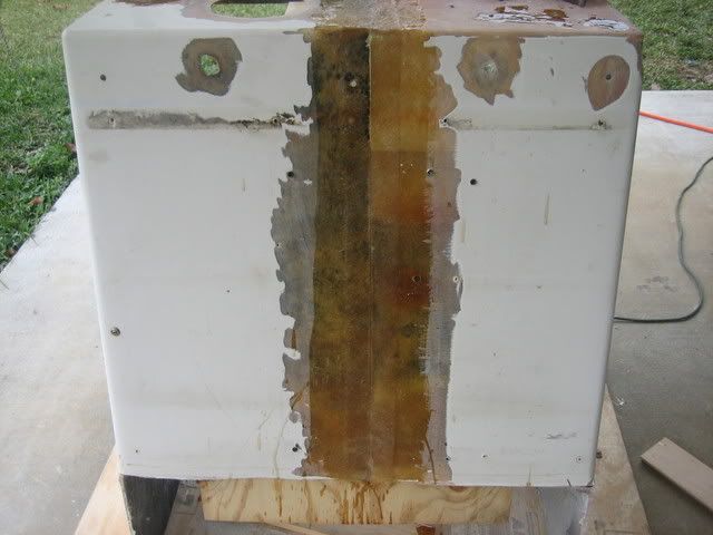

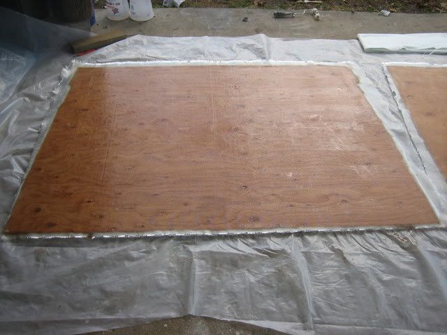

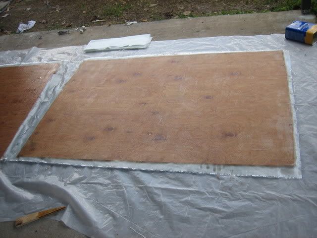

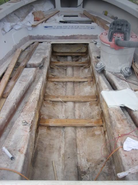

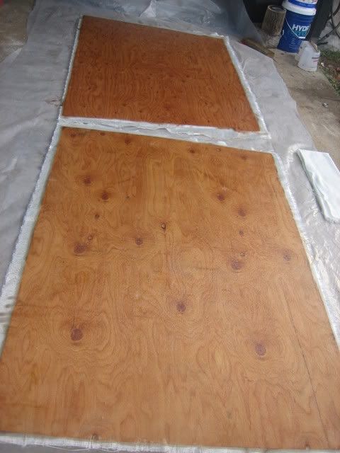

A little more progress I got the underside of the deck fiberglassed today and will hopefully have the new fuel tank in on sat so I can install the deck!

how did that glass dry the other day???

Default Re: 1979 20 project started
really good no problems at all....Picked up the new tank today and getting in tommorrow. My phone was stolen the other night I'll give you a call tommorrow. Cant seem to find my camera or I would put up some more pictures Oh I got the engine off as well! Im looking for the camera tonight more pics tommorrow!

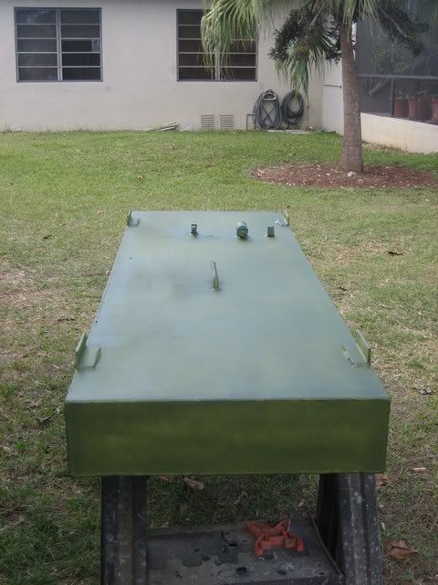

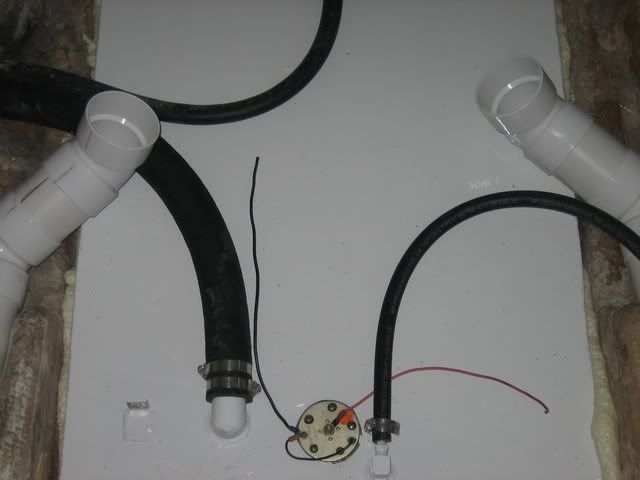

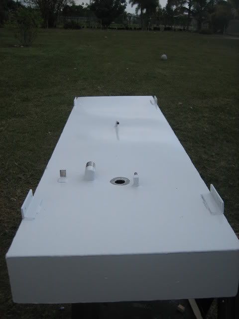

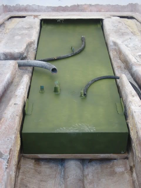

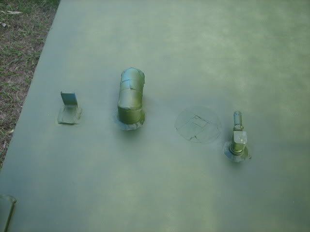

A litte more progress...Finally got the new tank in and got the first coat of primer on. Glassed in the new tank support and dry fit the tank, hope to get the deck in this weekend!

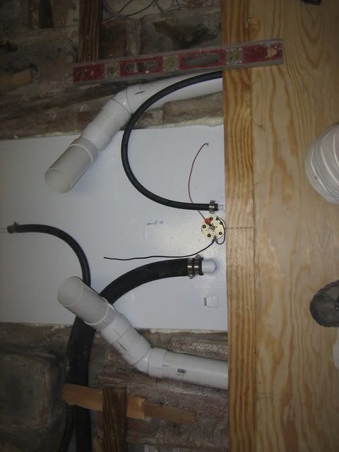

Got the tank painted and installed, installed the rigging tubes and dry fit the deck. Hope to glass in the deck this week.

Looking good what size fuel hose did you run? keep up the good work.

The fuel line is type A 3/8", And the fuel Fill is Type A 1 1/2", Thanks, I'm following your refurb looking good too!
