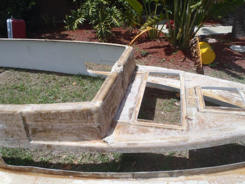

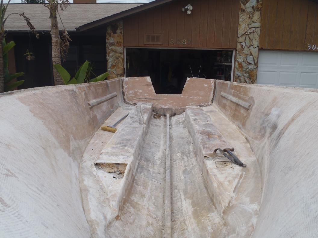

almost ready to start re-glassing. going to remove the center stringer tomorrow and get a new one cut and ready to install. I alson have some touching up to do with sanding. next on to gunnel cap, wich i havent started yet.

got the gunnel cap sanded and ready for glass. now its time to start puting it together.

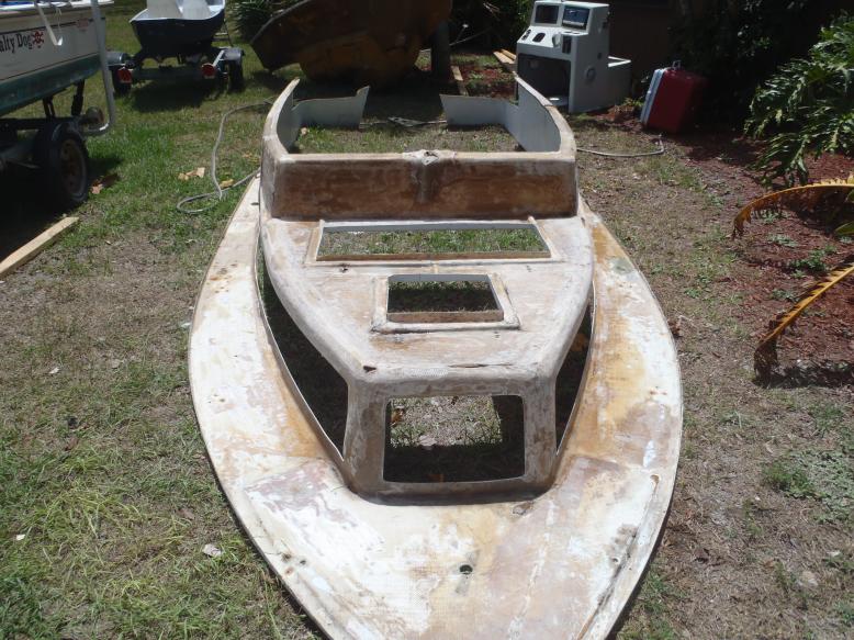

thought i was ready but i geuss i have to cut out the old wood on the casting platform and under the bow. seems like a good idea, but more grinding! grr!

Are you just recoring the casting platform and bow area or do you plan on recoring the whole cap?
If you were just planning on recoring the two mentioned areas..could you have left the cap on boat & in tact and done repairs from outside?

i am new to this and not sure what you mean by recoring. but the casting platform was real weak around fishbox and on the gunnel around the bow. the gunnel is pretty wide towards the bow and would like to be able to stand on it. I took it off to see what was going on under it and also to remove the old wood that is glassed in and replace with new, and am also going to glass in more wood under gunnel. It was actually very easy to remove gunnel cap. Now i have it completely stripped down and i can re-do everything.

Originally Posted by dandub20 View Post
i am new to this and not sure what you mean by recoring...
...to remove the old wood that is glassed in and replace with new
What you describe is recoring; replacing the wood core in the laminate.

then yes i am re-coring under gunnnel. i just want to completely re-store it. there are a few weak spots
