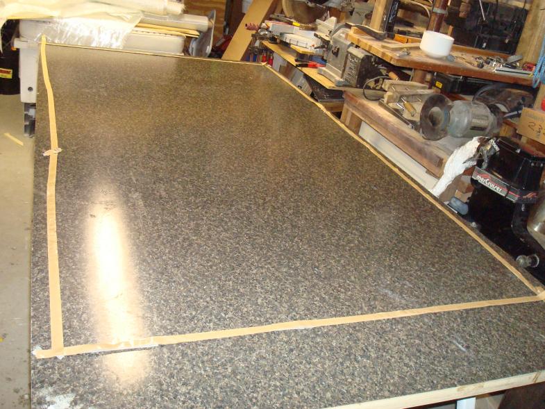

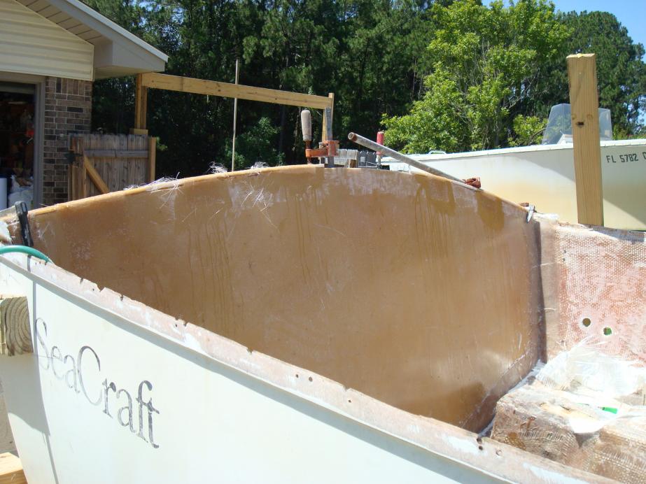

Here I have laid up and outer skin for the Transom..2 layers of 1.5 oz mat and 2 layers of 18 oz biaxial

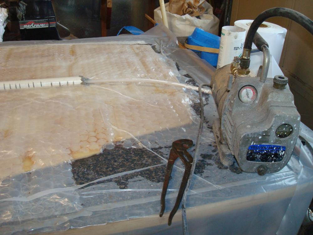

vacume baggin the inner skin with 2 layers of 1.5 oz mat and 18 oz biaxial and 1/4 corecell .. once laid up then i will go and wet oiut another layer if1.5 mat to the other side of the corecell fit it and tab it into the inner side of transom...

here are the poor mans vacuum bagging

Your vacuum baggin looks fine. What are you using to pull vacuum?

7.5cfm yellow jacket...

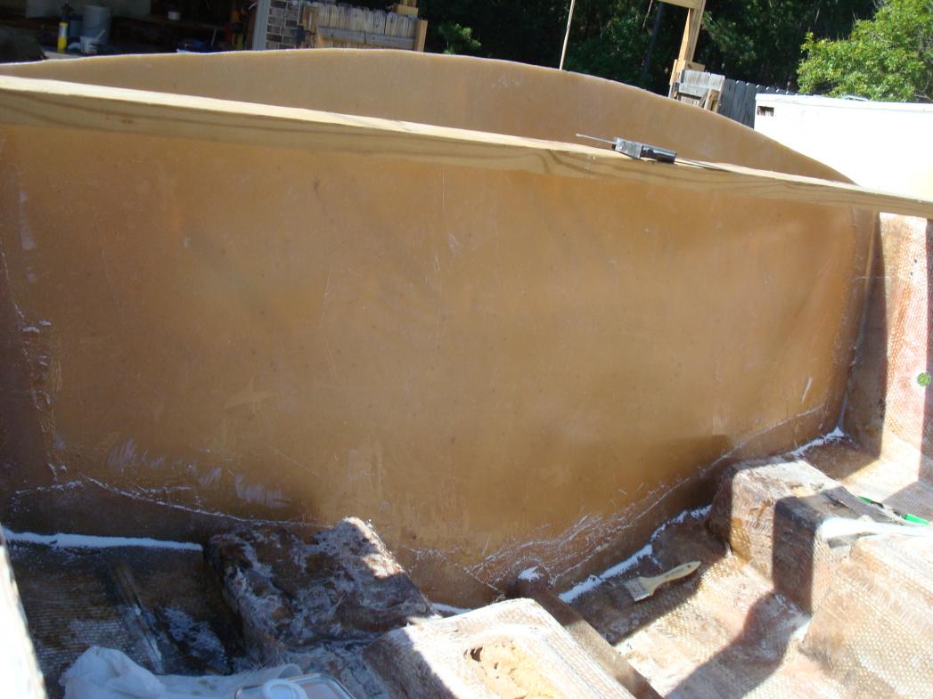

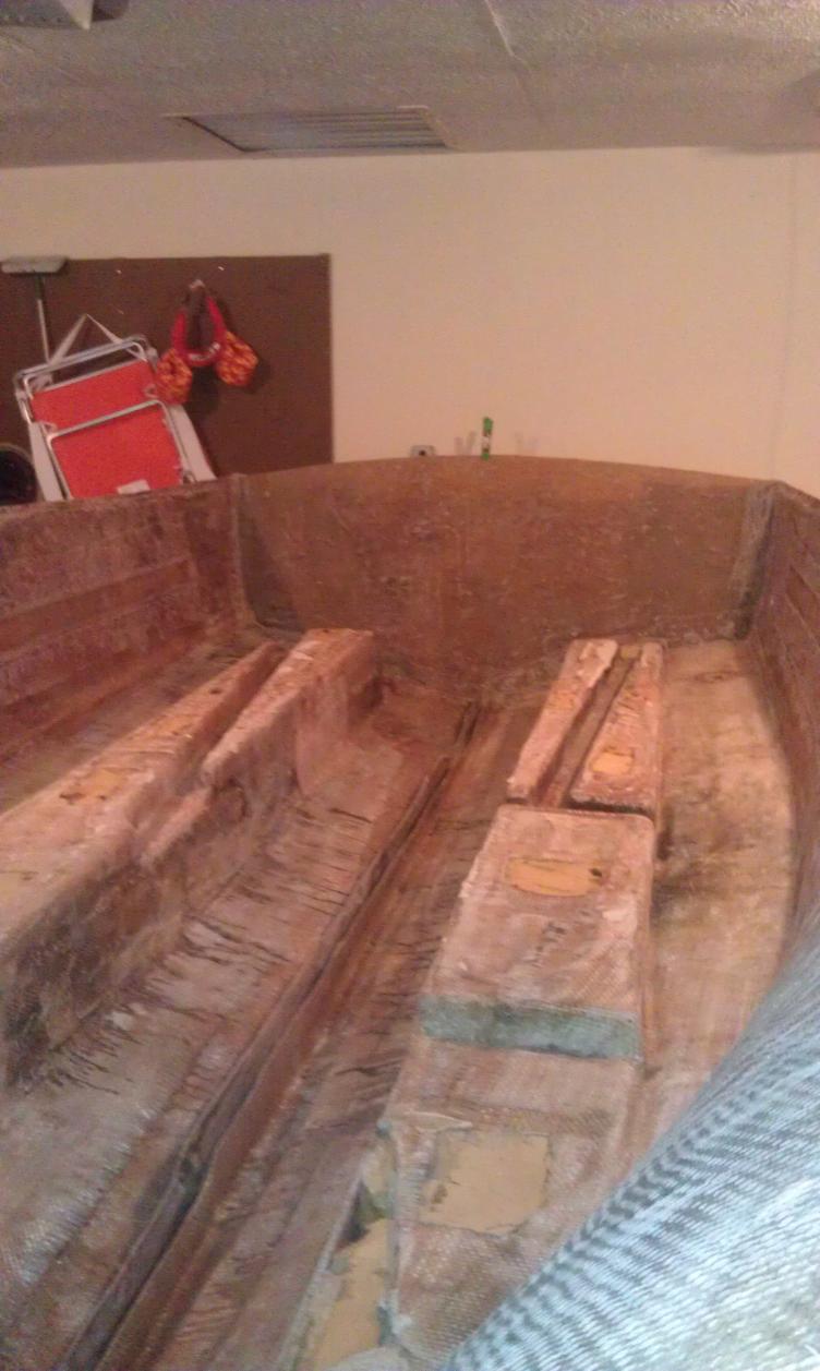

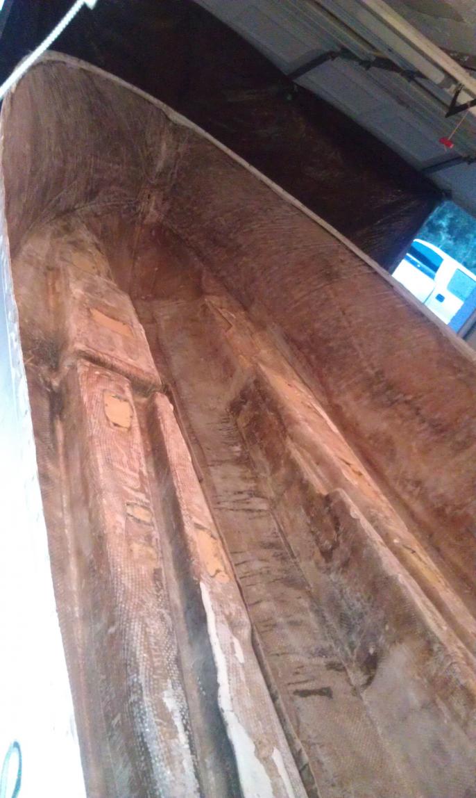

Ground the whole hull and jigged up. The stern.. will work on cap tomorrow and fit it before icore the hull and pour the transome.....

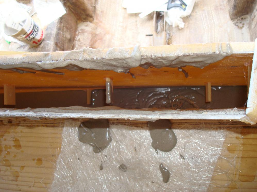

This is what i did after the rain stopped last week... Poured transom and added deck cap to start the hull Layup
What was supposed to be a 1.75 thick transom turned out to be 2.25" on the inside. and that threw my whole calculations off on the pour So i did not have enough to pour.. I pour what I could cause of the Resin window i was working in, and when my materials come in I will pour the rest. I will have to drill holes in to the cured resin so that i will get a better bond and some how rough up the sides...inner skin.. half inch really made a didfference when pouring.. made a temp cap so that i could pour the rest up to the top...

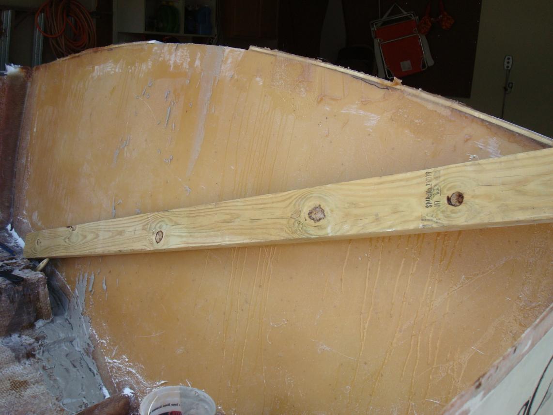

Basically more pictures of the Transom build. You can see a 2x4 in the hull at and angle... Well after pouring one bucket and I just happened to look inside the hull and what do you know, a leak. so I found what I could in the boat a used chip brush and some glass mat and veola a plugged the hole oh and a 2x4 to hold pressure till it kicked off.. the whole time cussing cuase if this did not work i can through the whole project away . Cause I would not be able to cut this crap out of the hyll . haha.. Anyway it worked Thank God
