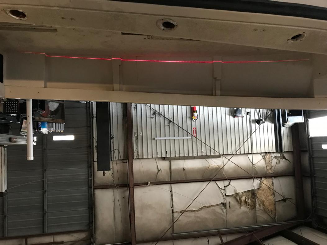

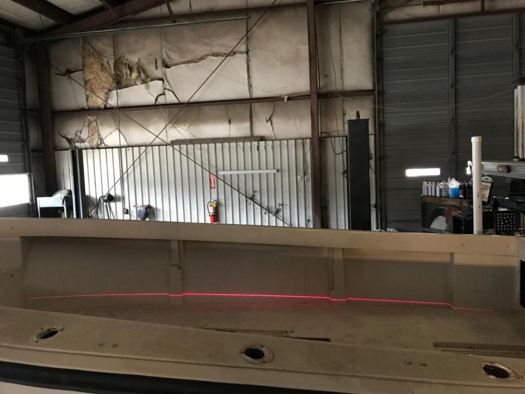

Here we go! Gutted the boat and started my plan of attack. Using a laser level, I laid out where I wanted the new deck to be. Raising it 4" in the front and it will be about 2" higher in the stern.

Is it me, or does that laser line bowed in the center? Like going from nothing at bow and stern, and 2 or 3 inches higher midship?
Looks like the pic was taken with a GoPro, no?
Vezo
  #30
Old 03-07-2018, 01:57 PM
IPhone 6. Just the distortion from the angle.
