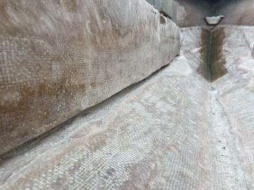

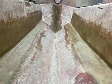

Post away...interested about the cracked Keel...did you have the original wood keel still in the boat? freezing temps have been blamed for expanding and contacting of the water logged wood keel in the past.
This is the second cracked keel I have fixed, and I’ve seen a few others with a nearly identical crack. It seems the 23 has a hard spot in the keel, forward of the center wooden stringer, before the bow eye. I basically grind a ton away on the inside, lay a bunch of glass on the inside, and then grind back to my fresh glass from the outside to eliminate all the bad spots. Easy fix if the boat is fully apart. I’m not a fan of the wooden center stringers, so they have been removed from both 23s and the 25. The 25 will only retain 2 of its original 7 stringers by the time I’m done.

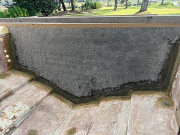

started on stringer repair on the 23, they were both blown out at the bottom and need lots of love, also got the 23 transom tabbed in, old through-hull holes patched up, and 25 transom cut and glassed on both sides, quick sand and its ready to go in the boat

stringers on the 23 have been getting some love and are almost ready for new foam, transom of the 25 is ready to be installed hopefully by the end of the coming weekend

Are you planning on building the grid stringers like your other 23? Coring the sides?

This one will have a partial grid to allow for some deck hatches port and starboard in the rear, but I'll be keeping a good portion of the original stringers towards the front of the boat. The 25 is getting a full grid with lots of hatches.
