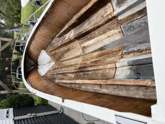

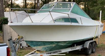

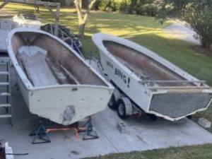

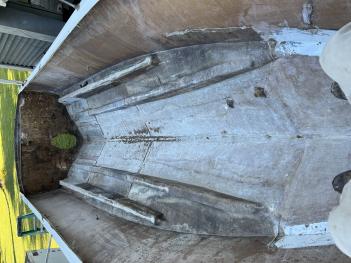

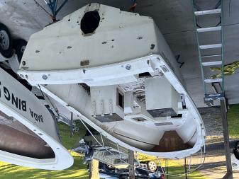

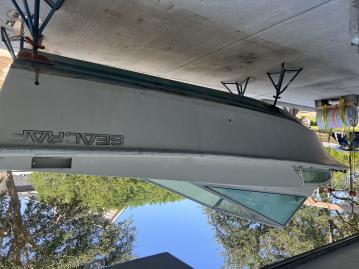

Default 25 seafari conversion to CC
I lucked into a 25 seafari for the right price to do a rebuild conversion. I know this is a debated hull for conversions and input is welcome, but she will be a CC.
