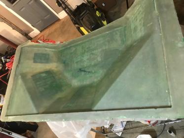

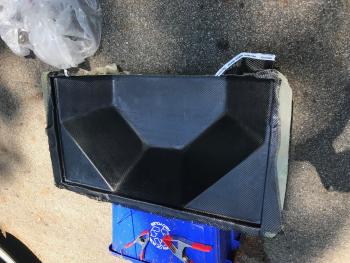

Some pictures. Almost done. Finally.
Twill and uni carbon with divyncel H80 core and Mertons vinylester epoxy.
Cross posted in the Hermco splashwell mold thread. I may pull a "pretty" part then offer up the mold.
This one is 8lbs.

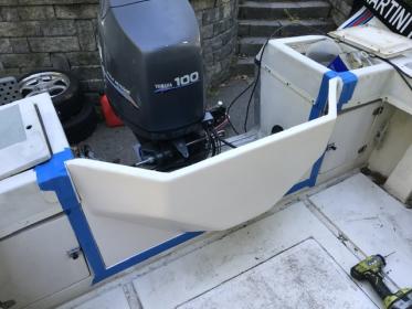

So the mold needs a doable tweak. It’s a long story but I forgot about the step in the cap. I ground it to fit but it could use tuning. Still, it works great and there is no perception of lost space due to the toe kick area. Gel coat had clumps so this has texture. I may sand and refinish if/when I redo the decks and cap.
