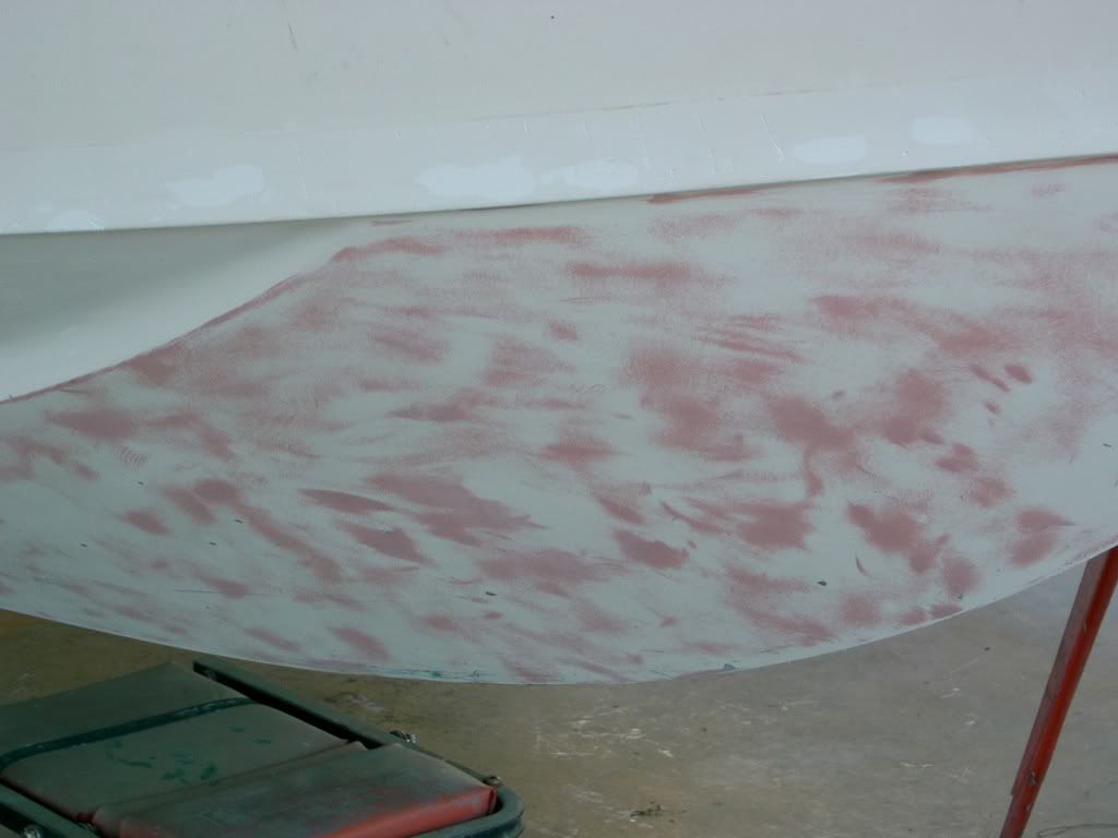

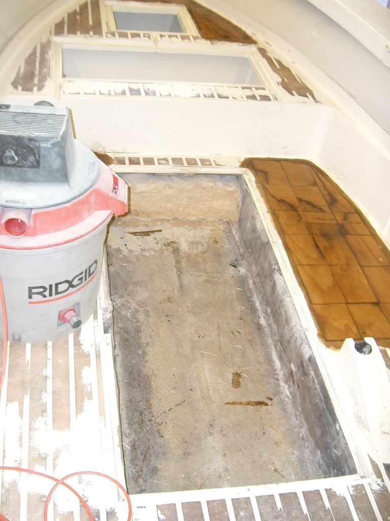

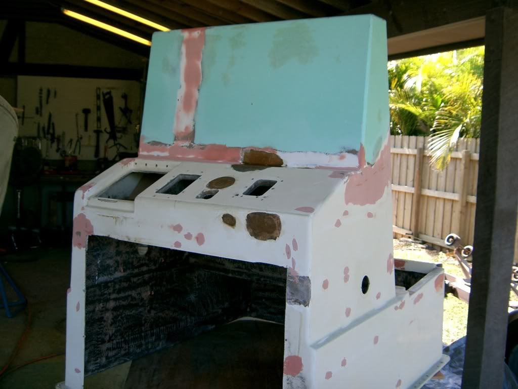

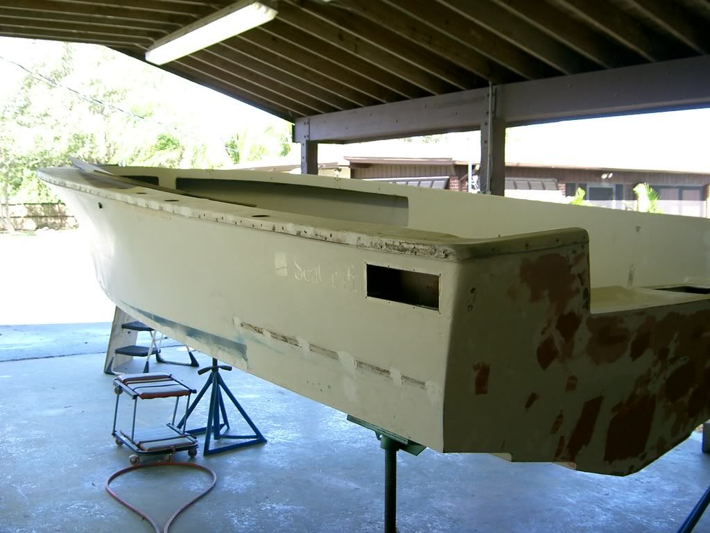

Now that every one has seen the beauty it is time to testify about the (Beast) this is what she looked like before the boob job and tummy tuck.
note the grinder marks that had to be smoothed over with Awlgrip fairing compound,
How could this old girl be the twinkle in my eye? Looking at her from the back like this, I'm almost reddy to cry.
With all these soft spots, I was so dismayed, I had to keep grinding and not get paid.
Now this original console that I fixed & raised up When I was finaly done I almost through UP! and that it the saga of the apple of my eye.
